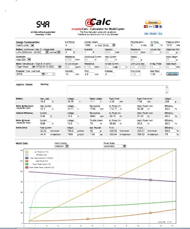

When I first got my DJI 450, I was using the stock 10 x 4.5 props with a 2200mah 3s battery. The stock motors were barely warm when landing. After experiencing the infamous DJI prop break I added some bling and made changes to the frame. I added extra upper and lower frame plates, a BEC for the LEDs and a bunch of LEDs. Unfortuneatly I did not get an AUW of the stock F450 before the changes. After I made all the changes I switched to GEM FAN carbon filled props, which are much stiffer.. The AUW with a 3300 3s battery is now 1502gms. I am using GenAce batteries rated at 25C. The motors are hot when landing, but the ESC and battery are only slightly warm.
I found a deal on SunnySky Angel motors for $13 each (sorry they are sold out). The motors are 2216 880KV. I tried the 10 x 4.5 and the motors are moderatly warm. I went up to 11 x 4.5 props and the motors are hot, although I got a 9:30 flight with 80% discharge.
I plan on adding a gopro which will take the AUW up to 1669 gms. I have a collection of props (GEMFAN carbon filled or APC) 11 x 4.5, 10 x 4.5, 10 x 3.8, 9 x 6 and 9.4.7. I tried using ecalc, but I am afraid the numbers don't mean a lot to me.
The props are ballanced and the bearings were removed and oiled.
Based on the info above, what size prop should I be able to use with out the motors heating up? Could the C rating of the battery contribute to the heating problem?

The logical conclusion is that 11x4.5 is too much prop for that motor with that AUW. With respect, you need to persist with eCalc - all the answers/understanding you need are in there. Try posting a screen shot of your numbers in eCalc and I could point out where you might have gone wrong.

The main issue I have is that neither the DJI 2212 or the SunnySky 2216 are listed in ecalc. If I knew a close equivalent then I could plug the numbers in, and ask specific questions.
jes1111
Yeah, that can be tricky. According to http://www.foxtechfpv.com/sunnysky-221611-kv800-motor-p-383.html these are a straight knock-off of this: http://www.rctigermotor.com/show.php?contentid=143, so select Tiger MT2216-12. The DJI is possibly an OEM version (or knock-off) of the Tiger MT2212: http://www.rctigermotor.com/show.php?contentid=145
Try it with these motors - massage the numbers (in a logical way) until the Hover Throttle and Flight Time agree with your reality - then you can change components to play "what if".

I entered information from the T-Motor and SunnySky (based on my best guess), Clearly I am not doing something right. When I tried to change the hover times, it went back to a predetermined value.
Is there an FAQ or similar on how to get the proper values into ecalc, and what the values mean? I appreciate your help, and if you can point me in the right direction.
