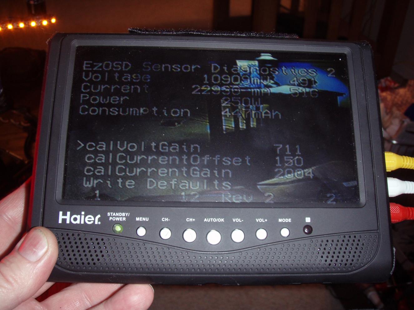

Here's the deal.
Got myself an ezosd with 100A current sensor.
When I first powered up I got the display but no voltage display. I am running a Boscam fpv system which has different pin out than FatShark. I missed the power swap on one of the cables and ended up shorting out the sensor.
While waiting for a replacement I uploaded the sensor calibration firmware and tried to see if the problem with the sensor was in there. It wouldn't let me do anything with the bad sensor so uploaded the TBS firmware.
The error screen would not go away, " error; current sensor diagnostics 2.1.
I could not get back to the main display screen.
Today, I received the new sensor and installed it. I hooked back up to the pcu.
The error has now disappeared but I can not get out of the diagnostics screen.
Went back in and uploaded the loader fw 1.3(?) along with the TBS fw 1.2.
I still can not get back to the normal display.
What am I doing wrong?
Tomstoy2
This is the damn screen I am trying to get out of,,,,

No, using the buttons to navigate, I can select, using the center button, I can navigate the cal and write default selections. Up or down change the value. The bottom line is just that, fw and rev#.

Well, the more I thought about it the more I decided that ol' Kloner was right, just contact Immerison themselves. Not the easiest thing. To do. Finally I found an email address on their website, ( not even linked ), and sent them an email.
Their response, just go down to the bottom of the page and press exit. I can see already that this. Is going to be an interresting conversation!

Just to let everybody know I have resolved the problem, after a few emails with ImmerisonRC.
Seems that the files I had downloaded previously had gotten corrupted, possibly by running the calibration firmware.
I deleted all the files, downloaded them again and installed.
Worked like a charm!
