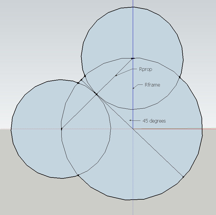

how on earth do you get 13" props on a 450 base quad?
basic math:
sin(45) = Rprop / Rbase
0.71 = Rprop / (450/2)
Rprop = 0.71 * 225 = 159,1 mm = 6,26"
--> Diam. Prop = 2*Rprop = 12.5"
so 12.5" props would just touch eachother on your frame...13 inch would cut eachother up. Are these props on different elevations ?
