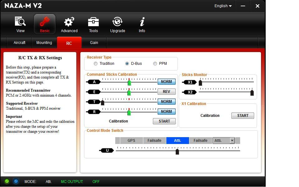

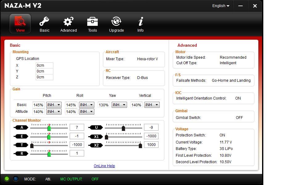

Hi, I'm hoping someone can help me. I just finished building my second multi-rotor, this time a hexacopter.....but I'm really a novice at setting things up myself. I'm using the Naza V2, and a Futaba 10J connected by S-Bus.
I've calibrated the ESC's, all the motors spin properly but when I try to arm the props nothing happens (both sticks down and in). In playing around with the drone though I was able to arm them by pushing the sticking together, centered... not sure why but they spin up and respond to all four inputs, also inside the Naza assistant everything seems to move properly - but my range is -1000 to 1000 not -100 to 100
I'm not sure where I've screwed up - can anyone help or offer a suggestion?
Thanks, Mike
View attachment 25868 View attachment 25869

First thing, have you done the stick calibration in Naza assistant? This is key to having the Naza and radio stick control in sync with each other.
Make sure your radio has the sub-trims at their center position before doing this. Also, make sure there is no expo set for any of the stick channels. If you find that the sub-trims/Expo were anything but centered, you should center them, do the Naza stick cal, and then redo your ESC calibration.
The reading in assistant is PWM, which should be something closer to 1000-2000.

Clean profile and redoing my settings inside of the Naza assistant did the trick, motors arm now. Thanks again.Haven't mounted my props yet, but i notice the power curve seems flat from 0-50% (by tone of the RPM) then takes starts picking up. Think there is a setting I need to adjust?
