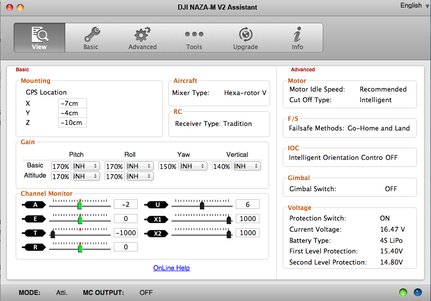

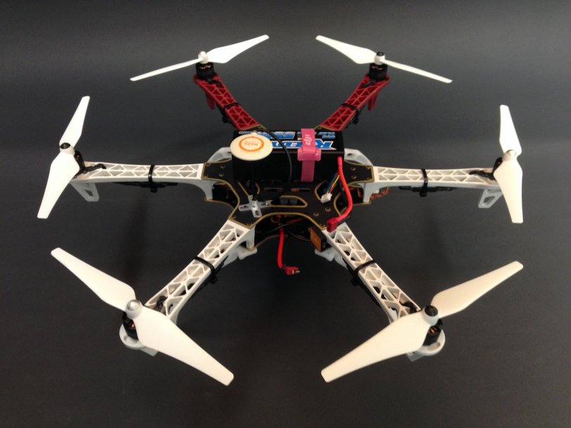

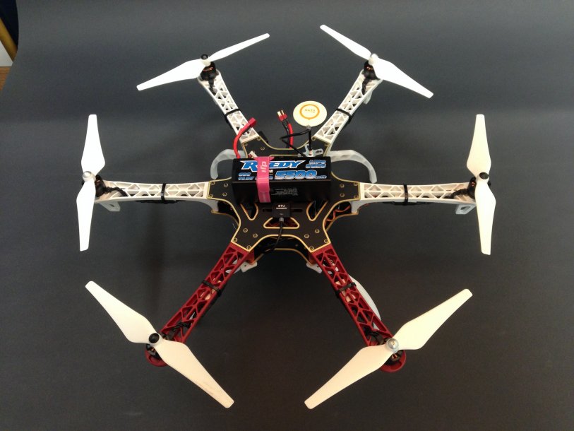

Here are some pictures of the F550 and a screen shot of the setup assistant.
@Gary, I have calibrated the sticks per the instructions, but that's not to say something obvious couldn't be the issue. The only stick inputs that I have used is throttling up to hover a few feet off the ground, and then back down because it's flat spinning — point being that I haven't really flown it past that point as I can't get it to stop spinning.

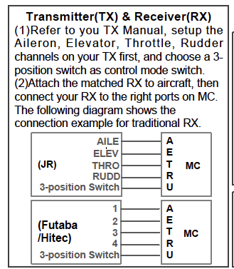

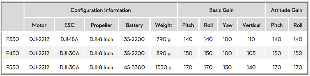

LuckyMike, did you build this rig yourself? Are you sure each motor is wired correctly (from the ESC) and spinning in the correct direction? Are you sure of your props (ie, CW prop to the CW motor and CCW prop to its CCW motor)? Also, your Attitude gains seem really high. I run about the same gains for Roll, Yaw, Pitch etc., with Attitude set at 100%.
Edit: A couple more questions. Have you ever flown this or did you just receive it? Are you sure of your wiring into the Rx? You do know that DJI expects the following order from the Tx, right?
CH-1 Ail
CH-2 Ele
CH-3 Thr
CH-4 Rud
luckymike
I did build the rig and although I wouldn't go around saying I am an expert, I do have over 25 years of RC building, flying, racing experience. I have even worked behind the counter at a hobby shop long ago. The point being that I do understand the concepts of radios, channels, ESCs, props, balance, ect. That said, this is my first MR build and I am fully capable of making an error or misunderstanding something.
To your question; the motors/props are all spinning in the correct directions verified via the setup assistant. I wired the Rx per the instructions found in the Naza manual and again verified via the setup assistant. The gains are directly out of Naza-M V2 manual (both sections attached).

SUCCESS! I went through the whole thing again and here's what I found - all the props were swinging in the correct direction BUT I had the clockwise motors/props on the arms where the counterclockwise where supposed be. I put the correct motor/props on their proper arms, checked the rotation and BOOM - it flies like a rock!
I want to thank you guys for prompting to look at the obvious one more time. Building this thing in one sense is pretty straight forward but then there again I got lost!
