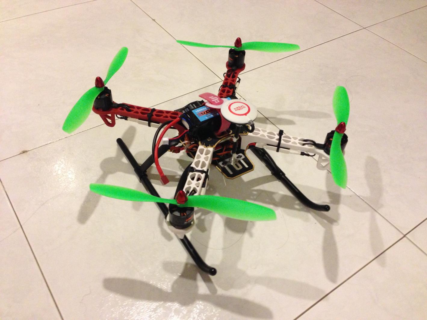

I use the Futaba 8J with my naza and its always been very reliable. I connect them using the normal channel to channel wiring, I haven't tried S-Bus.
one suggestion would be to try connecting them using the traditional channel to channel wiring to see if that improves things.
If your GPS isn't getting enough sats to get a good position hold might explain the shooting forward as soon as you flip the switch from atti to gps mode. Having the correct GPS antenna position in the naza is also important, otherwise you might get the ever-increasing circles effect.
Changing rx shouldn't cause such a dramatic change in flight stability, the rx only provides control movements to the naza, providing all the sticks move as expected in software assistant, the naza should still be as stable as before.
Were you flying in a bright sunny area, this sounds very similar to the "bouncy quad" issue that seems to be caused by direct sunlight shining onto the left-side of the naza and disrupting the barometer, causing very dramatic & unstable altitude control.
I hope this is helpful and you get flying again soon.
SMP
Thx Quad, not a bad idea going back to the traditional to test... was wired traditional w the Spektrum w no issues... Do have both sides of the Naza taped. Just the left then yes?
Basically I'm hearing that the two do play nice together so in all likelihood I've managed to bungle the swap somehow. I suppose the biggest surprise was that post RX swap the GPS wouldn't lock in previously mounted position. I put that down to RX interference but doesn't sound like the leading suspect now...hmm
quad flyer
I'm glad I could help.
I have both sides of my naza covered with black packing foam, but yes, it is only the left side that gets effected from what I've seen on various youtube vids and read on different forums.
the GPS & RC rx shouldn't cause cross interference, they are both passive receivers and work in completely different frequency bands.
I have a naza with GPS with Futaba R2008 rx crammed together on a little DJI F330 frame and its fine.
I know how "oh, I'll just swap that over" can cause all sorts of grief, I've done that way too many times, often without back-checking everything and it all ends in tears.
Maybe try re-check all the wiring, go through it as if its a "new build", pulling wires about can very easily disrupt other things.
I hope you manage to get it resolved.
