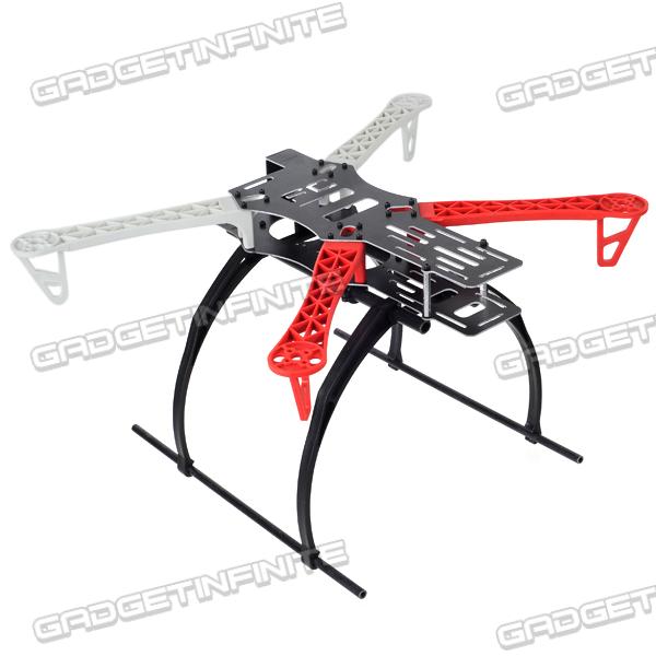

I thought i would share my next project now that all the parts are on their way! I wanted a frame that looked like the TBS fpv frame then i found this while i was looking through eBay
I have the following parts on order and hope that ive done a good job at selecting them
DJI Nazza with GPS upgrade as a kit
4x NTM 28-26 brushless motors with mount kits and prop drives
4x Mystery 30A esc i wanted something i could firmware upgrade and these made logical choice to me
1.2GHZ av tx/rx 500mw and ccd camera
2200mah Turnigy nanotech batteries
I did also order a bunch of hardware i.e. silicone wire, bullet connectors and mesh wire cover, now im just waiting for my parts to arrive and get building! ill try and keep this thread updated as i go

There are 2 main reasons i chose the cheap china copy, at the moment my skills suck i mean i can get off the ground, hover and basic fly but cant get a flight for more than 30 seconds before i mess up and my quad comes to the ground with the grace of a house brick. my current quad i scratch built to be tough (16x16x3mm alloy with 2mm centre plates) ive seen it crash to earth at a fair speed with little more than smashed props to show for it. until i know how to fly id rather have a china knock off than see a tbs frame smashed to bits. The second is because i plan to measure the angels of the booms and their spacing so i can build my own customised frames, i have a few crazy ideas ;) My dream would be to buy a 3040 cnc and build my own multi rotors from scratch.
