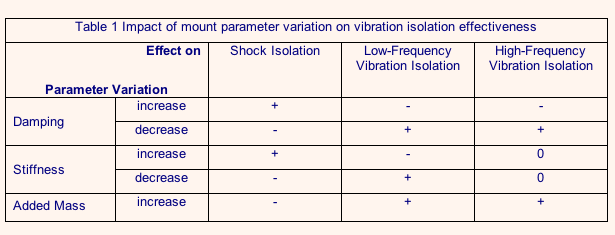

Combining items onto a secondary board is a smart move - the higher the mass, the more effective your isolation is likely to be (see the attached chart).
