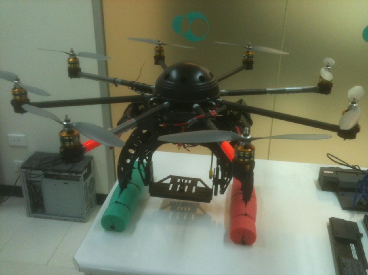

Hi Matt
We run a Droidworx HLift OKto in our business with the same motors carrying a AV200/360 Camera mount and 5000 mah Batts . Without a Canon 5D hanging we are looking at a whisker under 5kgsView attachment 8319
M
Martin Rhodes
Guest
Matt
Which only answers half your question. We work on max weight at T/O as 8 KGS with payload, that is what our OKT) is licenced in our Operators Certificate to operate at, but that is way over what we fly at (safety margin) You also want a controllable descent rate, in other words it doesn't come down like a ton of bricks if you are over zealous with reducing the power. It also is the max you would want to stress the frame and the mount, particularly if you have a bumpy landing. The Canon 5D plus a ninja hard drive adds about 2 kilos to the weight so in reality we are probably more like 6.5kgs at takeoff. Flight times if you are lucky are about 7-8 minutes, max. GoPros about 16 minutes, but production companies want 5D HD Video not GoPro.
To be honest 6.5 kilos is stretching it a bit structually & flightime wise, but a previous post said 5.7kgs I reckon that is pretty right.
Martin
