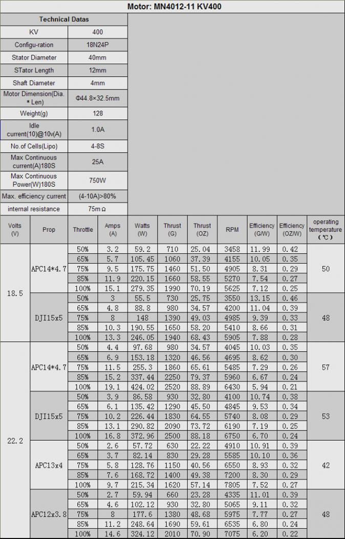

Hey Beresford! The chart says it draws 19.1 amps at 6s with 14*4.7 prop at 100% throttle. Does the amp draw change dramatically when the lipo is 75% depleted?

21lbs is 9525grms
divide by 8 is 1190g per motor. per the tmotor chart that puts you around the 60% drawing 6 amps or so but tmotor tested the apc 14.47 prop which is not what you have. the prop you have i know is more efficient. the best thing to do is monitor how much you put back in when you charge but again that will vary on the packs you use and the amount of cycles the packs have. rpm is voltage multiplied by motor kv so a good pack will hold better at 75% and a bad pack will sag quickly under load. your rig should be able to hover at 50% battery power which in your case you should be fine. i think hobby king sells a gizmo that monitors voltage remotely or get the eagle tree but the best system is to monitor flight times/mah put back in when you charge. in regards to the Y6 what motors? the new simonk i hear is 600hz not sure if that will make it fly better but interesting.

they look the same as the hengli and i think foxtech brand also. it may be the same motor but the hengli's i know are well balanced which is a plus for multirotor. i would do some final weight and thrust calcs first as these motors are only 300 watts and with the y6 you loose another 25% or so of thrust. i have some test data for the hengli will try to dig up.
