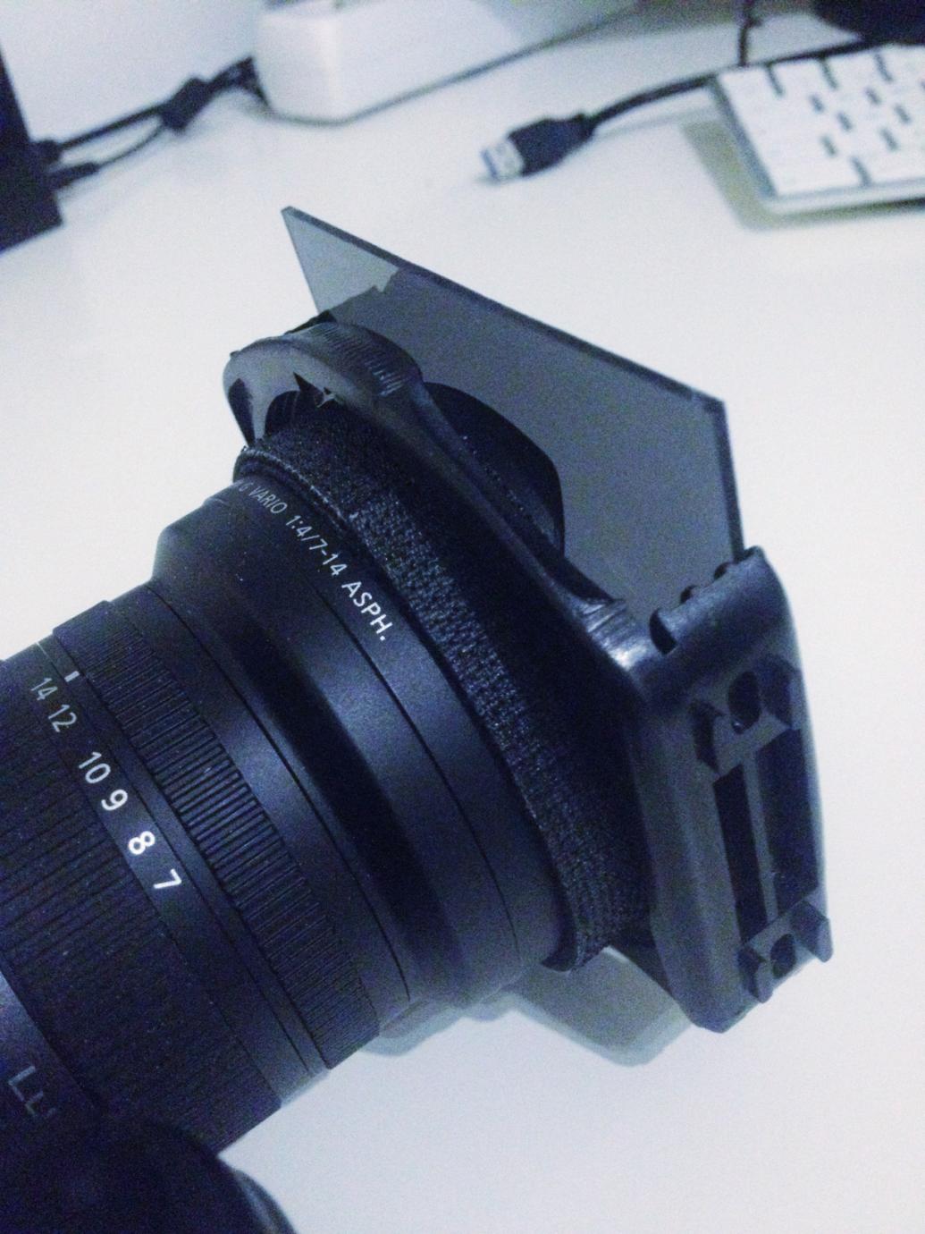

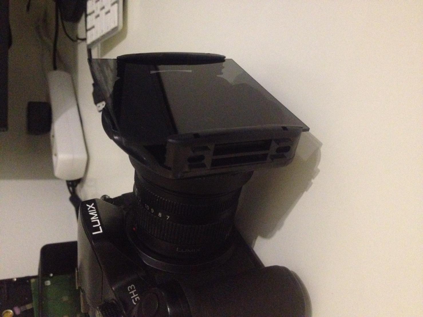

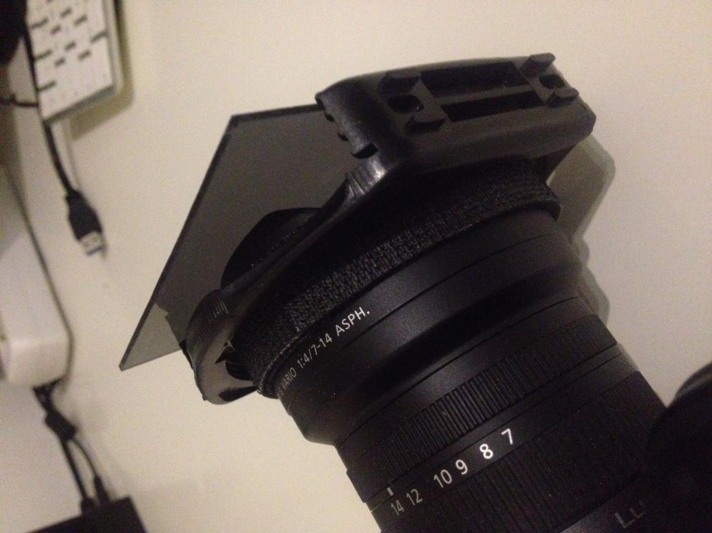

I really like my 7-14 too. Here's how i solved filter issue. I used Cokin filter holder without adapter ring, added some velcro tape between holder and lens until it's tight and it's working really well. Why i ended up this route instead round filter, this is not vignetting in corners at all even with bigger GH3 sensor, but i use it mostly with BMPCC where circular filters are not that big problem.
View attachment 16500View attachment 16501

vignetting like this,,, mine is showing till about 8.5mm

Exactly that's vignetting it does helps. I can use it all the way from 7mm up now. I haven't yet notice any problems with light hitting behind the filter, usually the copter above the gimbal protects quite well from that. Also you can use gaffa tape to insulate leaking light if necessary. Cokins are cheap, around 20 bucks the holder and filters are cheap as well.
