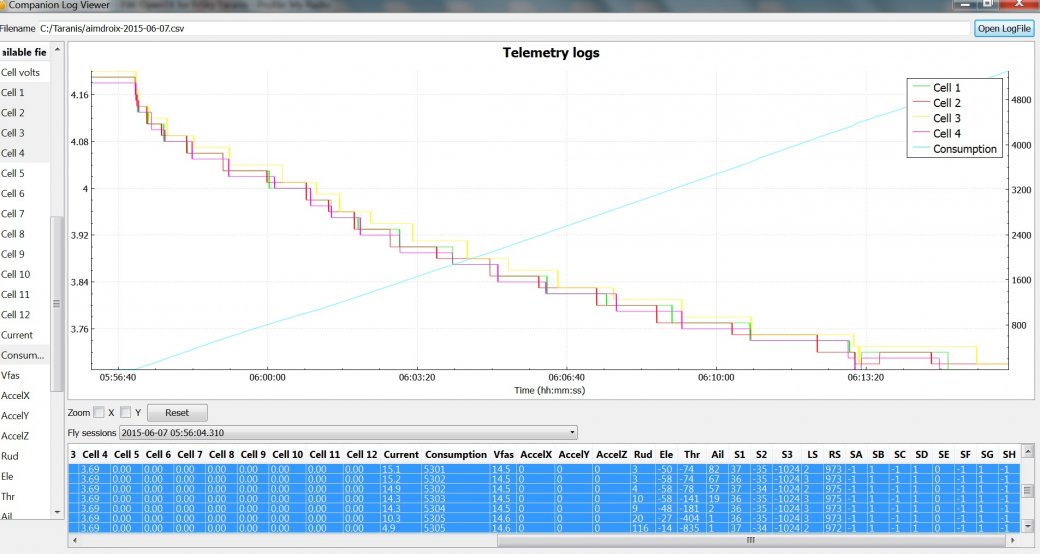

Never lower then 3.6v per cell under load or 80% mah used which ever comes first. Correct way to know exactly is to use telemetry with current sensor w/radio or OSD. I have never hit 3.6v before the 80% mark.
