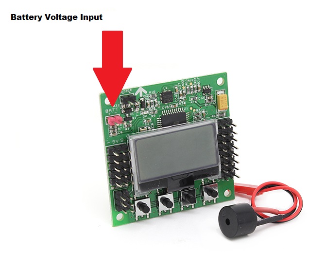

Right. That's the whole 1/10the volt thing. Seems like you have it programmed correctly. Maybe double check the wiring???
Do you have a full charge in the 3 cell? 4.2v per cell for a total of 12.6? I have a 4S and I set my voltage warning to 140 and haven't had an issue.
