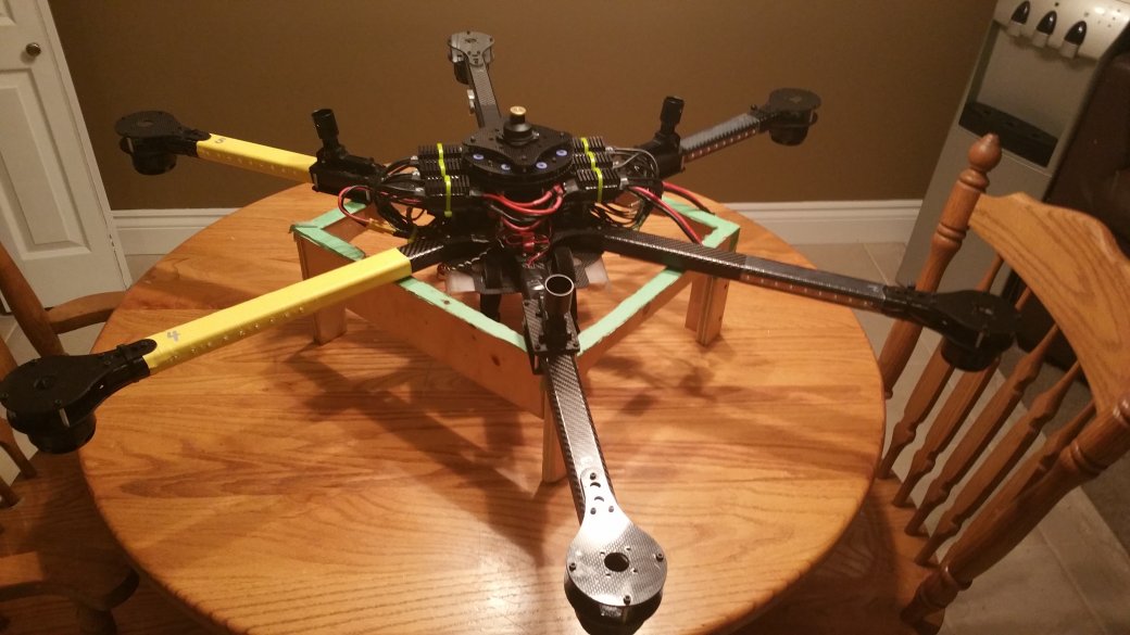

I have an S500 Frame.
I'm going to put a Pixhawk flight controller:
*Looking for ESC/Motor/Prop combo suggestions
I've been told to use
Hobbywing RotorX 20A ESC's
Emax MT2208 660KV motors
12" CF props

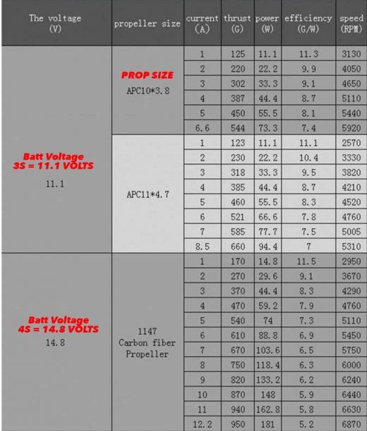

I found this chart for the motors, but I have no idea how to interpret the numbers...
http://www.emaxmodel.com/brushless-...ultirotors/emax-multicopter-motor-mt2808.html
