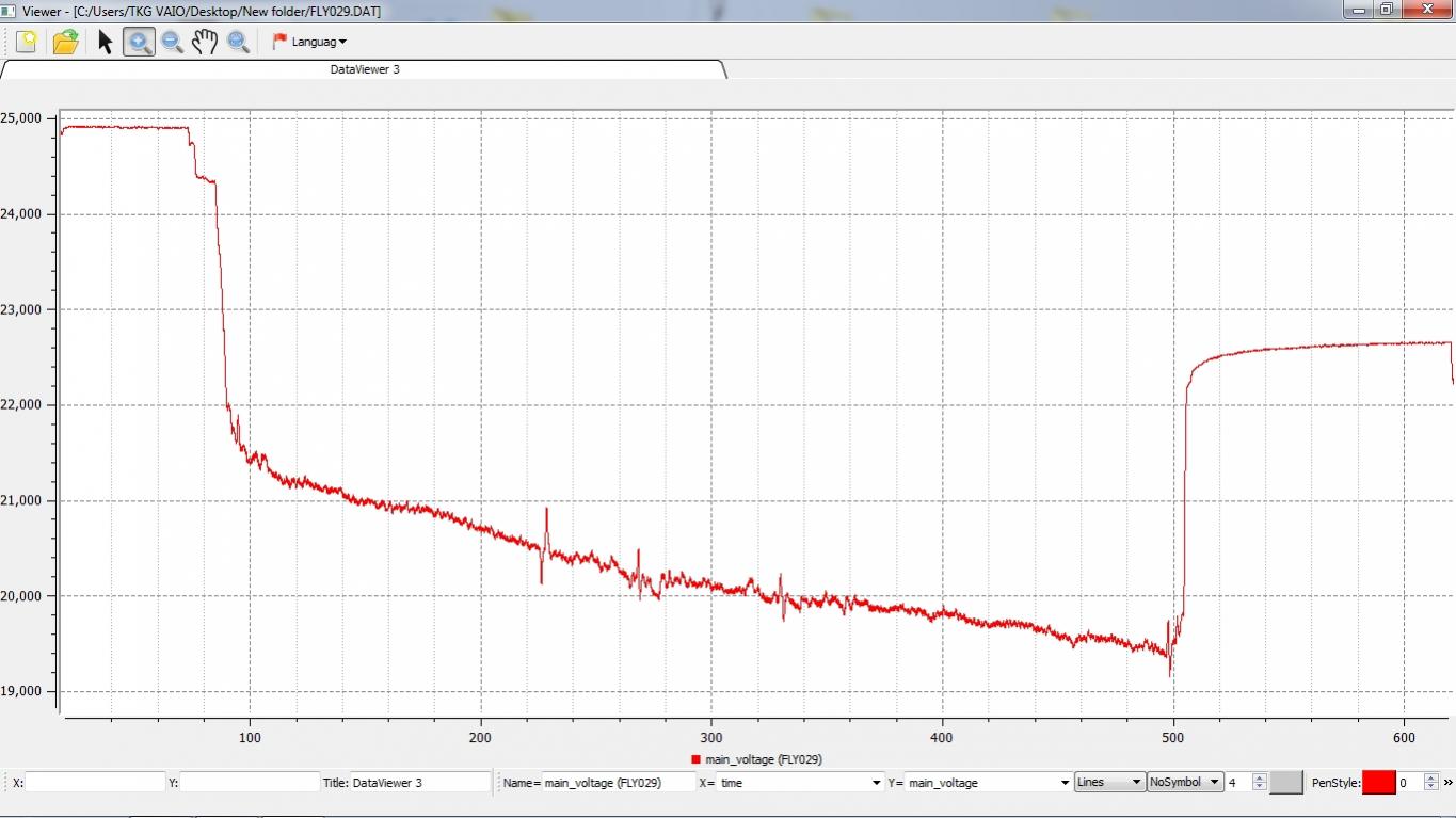

So last night I performed the test again and checked out the data in the iOSD DAT file. I'm not gonna lie, I don't know how to read everything in the DJI Data Viewer (thanks DJI for leaving yet something else completely cryptic) but the "Main Voltage" under FLY DATA seemed like common sense to look at.
Test was done on my Zippy 5000mAh 45C dual packs. IR of all cells between 1.5-2.2
Total length of the flight was 7 minutes in a simple 6 foot hover.
I took readings every minute comparing iOSD feedback to the Wattmeter directly connected to the power source:
Startup: 25V
1 minute: iOSD: 21.1V WattMeter: 22.7V Difference 1.6V
2 minute: iOSD: 20.6V WattMeter: 22.4V Difference 1.8V
3 minute: iOSD: 20.1V WattMeter: 22.0V Difference 1.9V
4 minute: iOSD: 19.9V WattMeter: 21.8V Difference 1.9V
5 minute: iOSD: 19.8V WattMeter: 21.6V Difference 1.8V
6 minute: iOSD: 19.7V WattMeter: 21.4V Difference 1.7V
Here's a screen cap of the data log Main Voltage pulled from iOSD after flight:
The only thing I can think of is since the power is routed through so many things before it gets registered in the iOSD, would that explain such a huge difference? I don't see how that would matter.

is that fma charger number?
try checking the ir of just the main pack connector..... the individual cells shows what the cells are, the one connector number shows you the loss in the connector.... what connector are you using to the main packs?
those voltages look pretty close to normal. might be a half a volt lower than i'd expect. i was flying towards the end of a pack the other day, 800 with twice the wattage of a s800 and it was sagging down to 20.2 and landed at 22.1. the graph is how these usually look..... flatter the better but it has to drop voltage somehow.

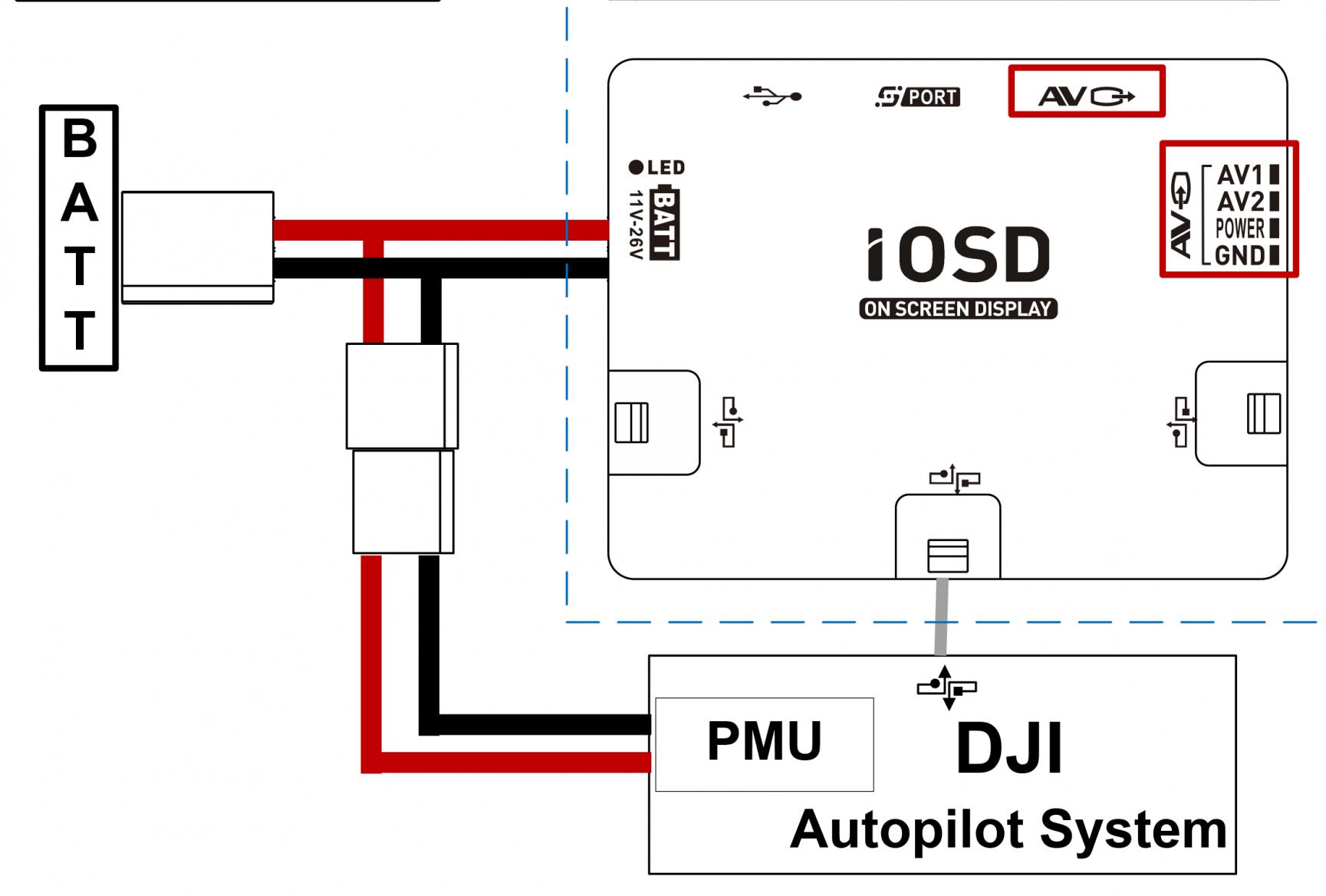

the osd has it's own power plug, it shouldn't be powering through the can..... big thick red and black wires.... if your saying there not hooked up,,,, there ya go.
R6Media

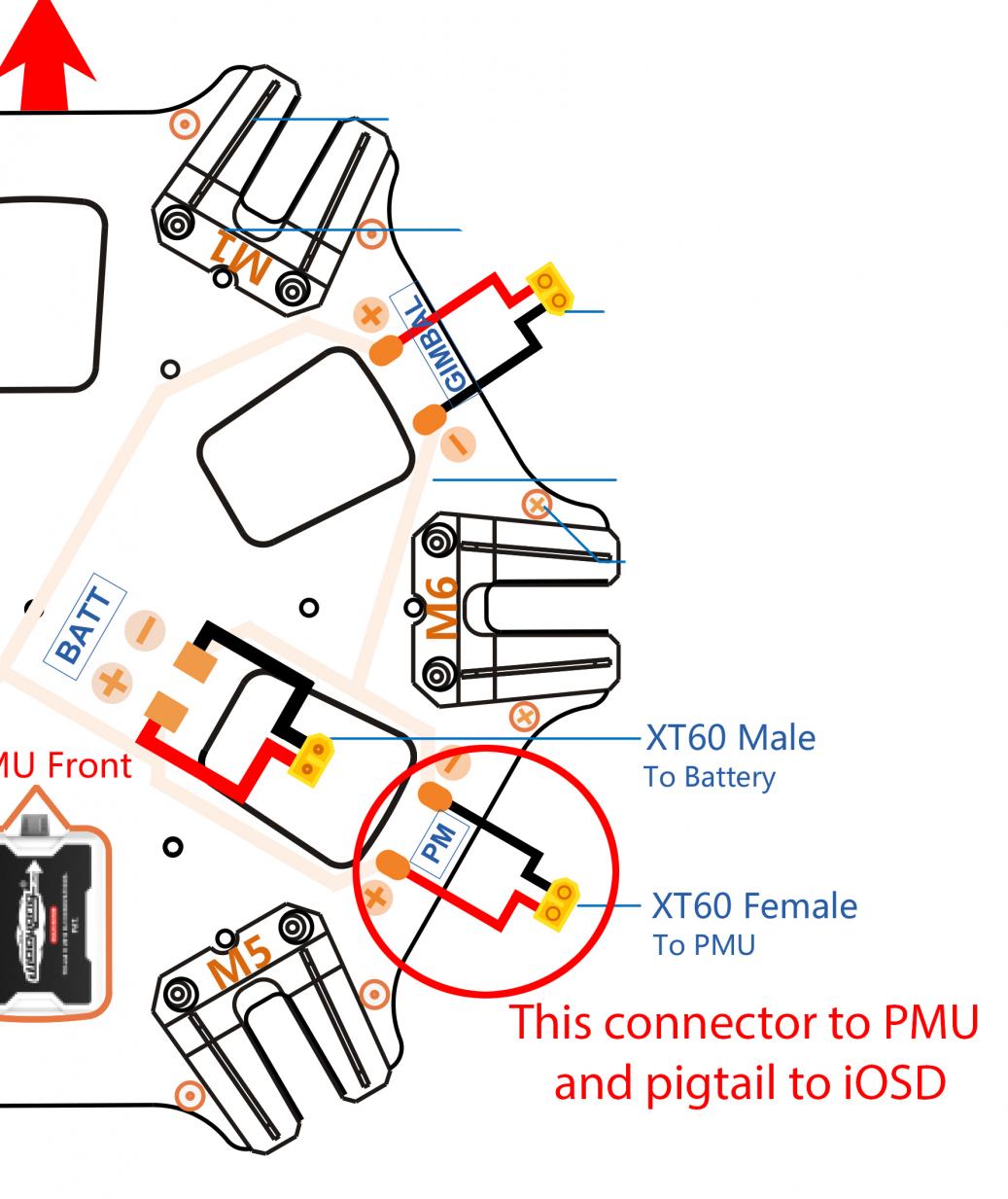

Kloner/Tahoe Ed - sorry my mistake on the iOSD getting it's power from the CAN BUS. my setup is very neat and I can't see all the connections in there. I made the assumption based on what I saw. Watching the iOSD install video i remember now that it has XT60 connector. Upon closer inspection... my iOSD XT60 power pigtail is shared with the power connector for the PMU connection and not the Main Battery connection. I don't see this as a problem do you? I assumed the thick wires (main battery connection) was just direct to battery with nothing in between.
View attachment 14958 View attachment 14959
Kloner: I don't know what you mean by FMA Charger Number, sorry. My packs and connectors for main power are all EC5's. I'm assuming you mean for me to check the IR of the connectors with a multimeter?
