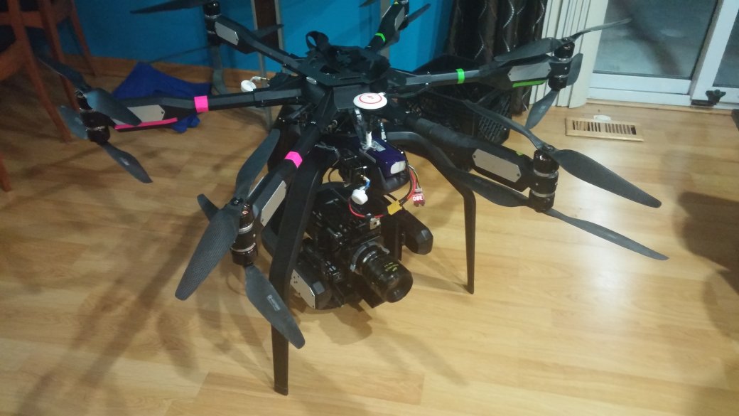

So anyway, I'll include some happy before and sad after pics. Also my iOSD log of the flight, which I find hard to interpret. Please comment on all of this or none of it... thanks for listening.

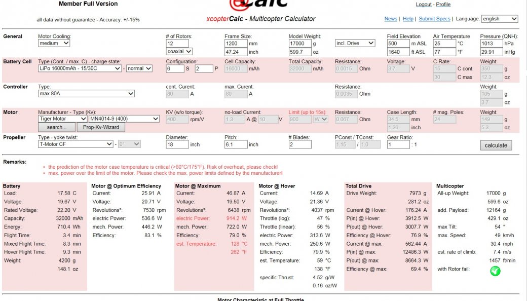

You have 12 x 4014's. They are good for about 1000 grams of lift each with 16" props. Let's take away 10% efficiency loss due to coax configuration. That only leaves you with a safe load of around 24 pounds. You were close to 40. Ouch.

Pumpkin, it was running 18" props. I'll admit I was skeptical about the company's rating of max 50lbs considering the specs, but I figured they knew more than I did? Like I said, we tested it with almost this much dummy weight multiple times before with no problems. They claim the gimbal can take up to 20lbs of camera. The thing retails over $60k new! Admittedly the only reason I even considered buying it was because I got it for MUCH less.
My reading of the T-motor 4014 props with 16" props shows 1920g of thrust at 65% throttle. What are you reading? See here: http://www.rctigermotor.com/html/2013/Navigator_0910/40.html
Interestingly enough, the 4014 motors don't appear to be spec'd to run 18" props.

fltundra, those numbers make it seem like the 4014s are ok? 56% hover... They only get slightly in the red at max output...
