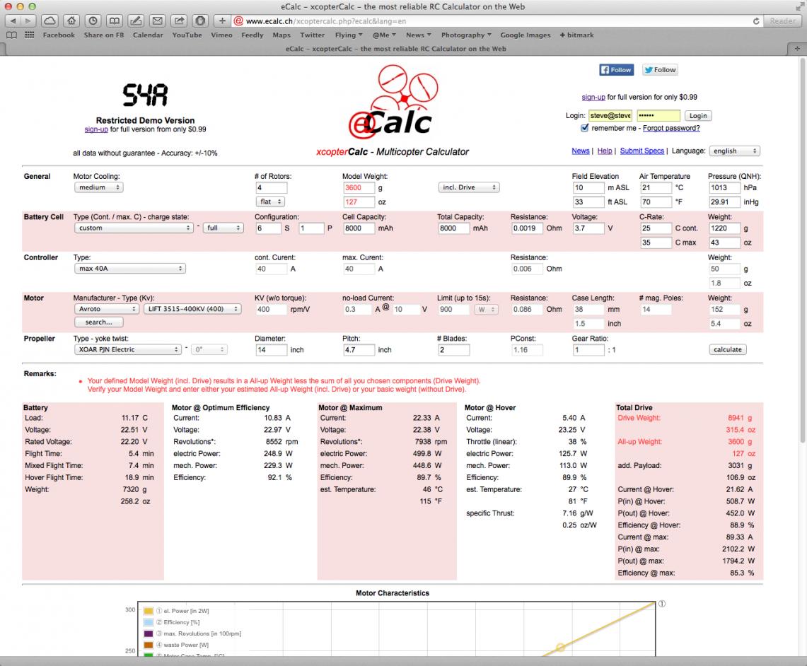

I can't for the life of me get ecalc to work for me.
I've tried it on Safari and Chrome on my Mac and IE on my PC.
It seems to be calculating huge numbers for the weight of my copter.
Can anybody get it to work at the moment?
I understand they've got technical issues regarding login, etc.
Here's what it's spitting out. Note the way out-of-bounds numbers at the bottom for the calculated weights. It's adding on over 5KG to the weight of my copter! :-(

Motopreserve
I just ran into the login issue last night. Not sure what is going on - but it's a bit frustrating that it worked better BEFORE they began charging for it. :)
stevemaller
Heavy Lifter
Well, now it's working. Some very interesting conclusions, too.
