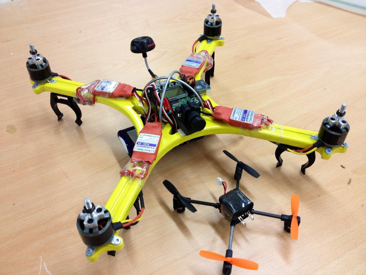

I was never really happy with the frame, flexed a lot and also seemed quite heavy, so being a carpenter I designed my own (plus a major crash breaking 2 arms helped)

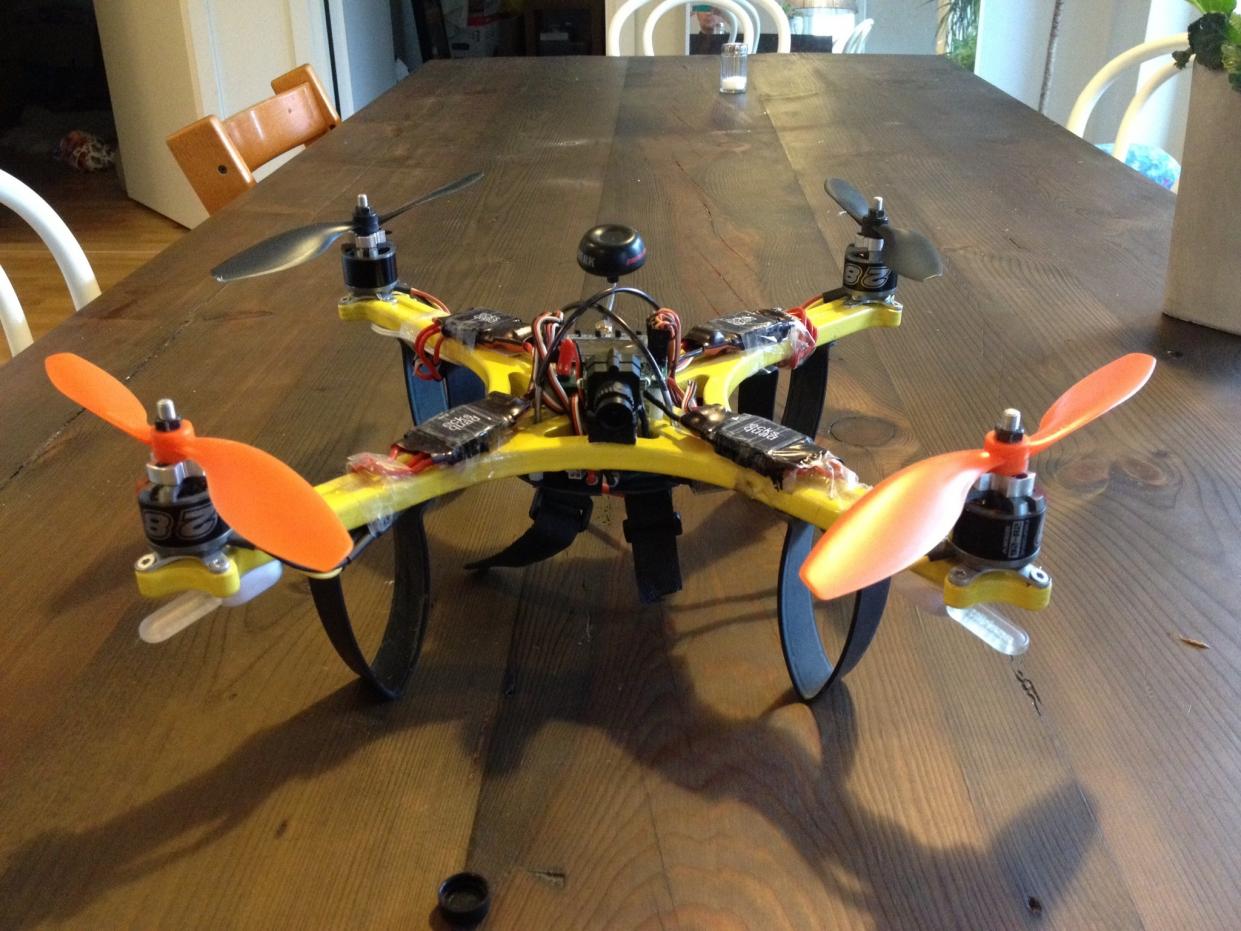

This was a nice lightweight plywood frame, 450mm and 210g, but I had a serious crash when I tried to flip with auto level on by mistake, 40metres up straight into the ground (concrete) and broke a leg, props and motor.
I decided to make the arms shorter, giving more strength and making it lighter, it's now 375mm and weighs 150g.
998g with everything including fpv gear and 4cell 2650 battery.
flies superb! It's a bit scary how fast it is!

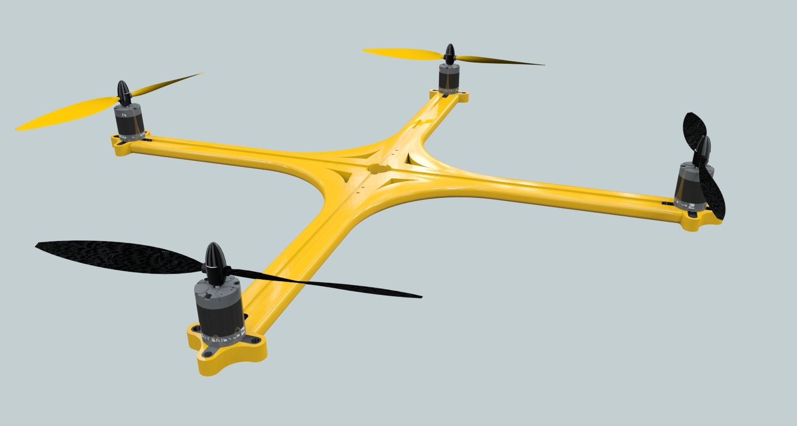

here is the final design.

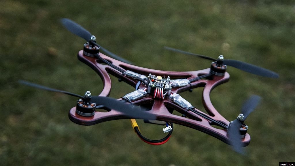

And a mahogany version

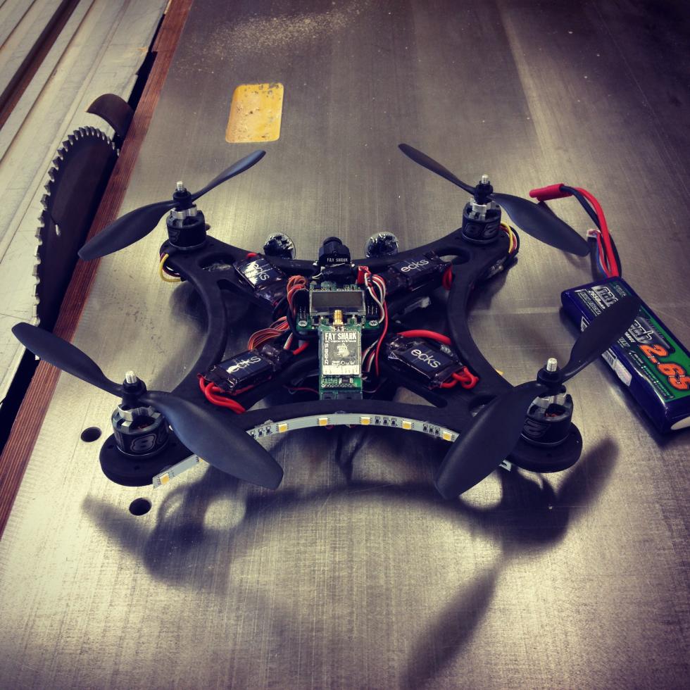

updated my frame to version 2.
310mm diagonal
144-150g (I sand down the final bit by hand thats why there is a difference)
designed for 8 inch props.
The first design broke as it didnt like meeting concrete at high speeds. So Ive reinforced, the change in size also helps the strength.
