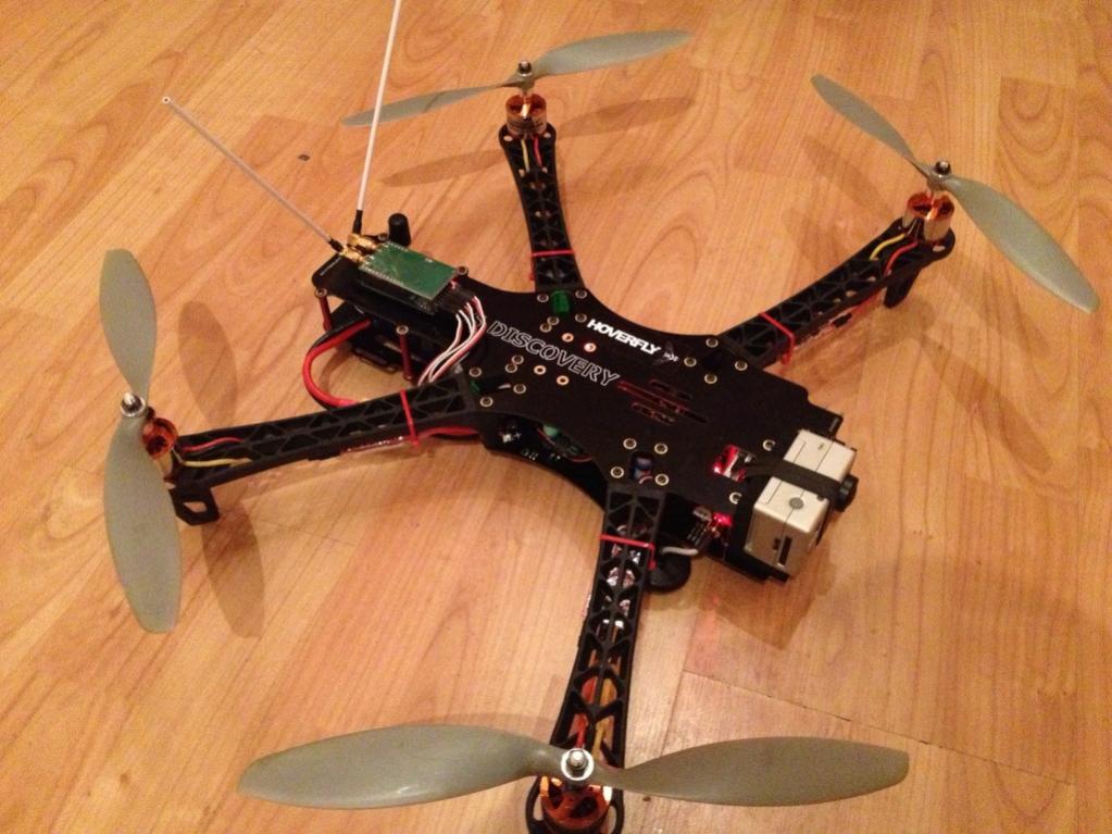

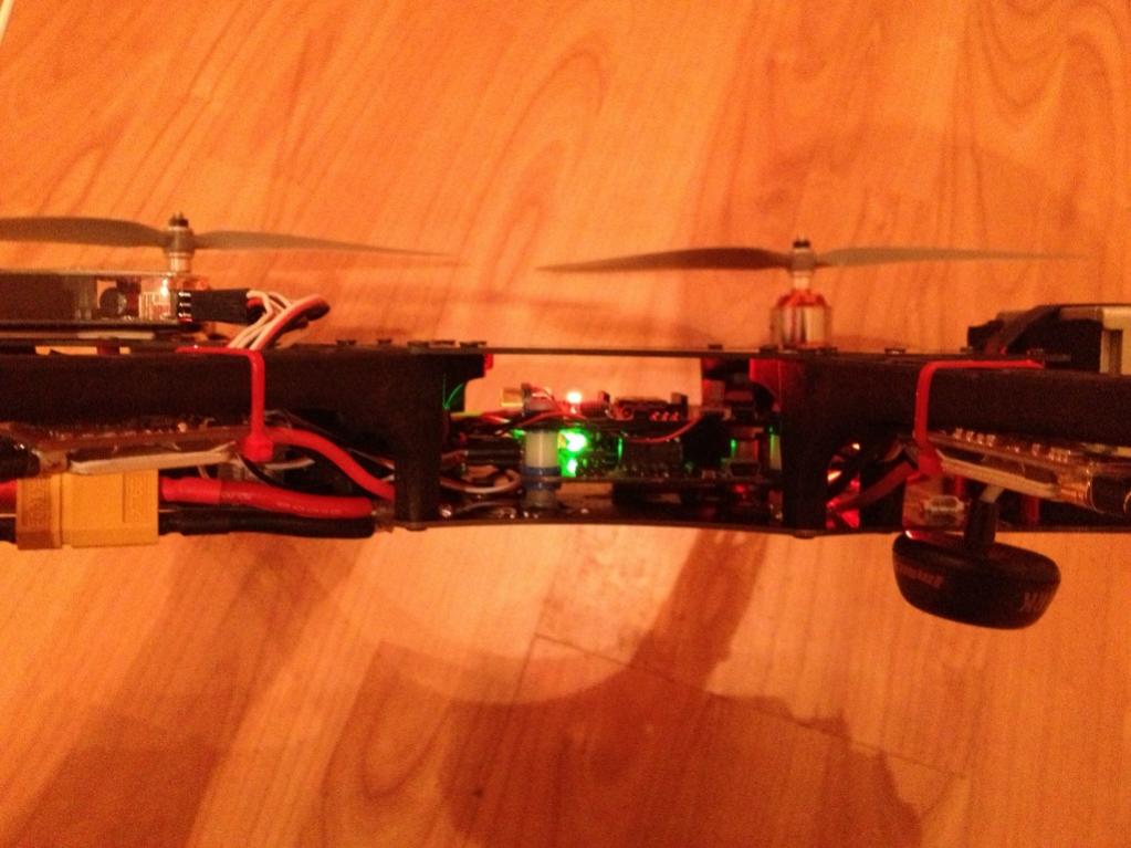

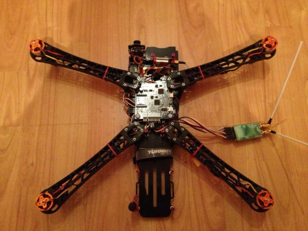

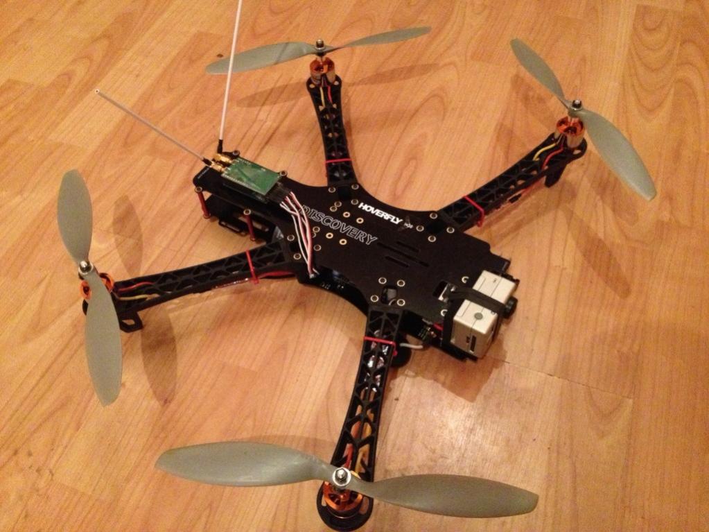

I've recently acquired a TBS discovery and the only FC I had laying around was a HFP/GPS. I fitted it (with some persuasion, but there is lots of space in there), updated and calibrated. The board wasn't flown since 3.? But it was flying well then. I figure its overkill for an FPV bird but what the heck, super stable and RTH with and OSD built in, what could go wrong?
Everything.
As you know the frame is asymmetric but it hovered fine and I tuned in a stable hover. That's where it ends though, everything else is weird, a fast acceleration and it give fast wobbles like too much gain, any type of decent ether forward or through prop wash gives unstable slow uncontrollable wobbles and it almost falls from the sky. No matter the gain I get both extremes.
Hovering at 10 feet and activating AH it drops like a stone only just recovering before hitting the deck, no matter the gain.
So, is it just the asymmetric motor layout, the so called flexi arms (I've since tried another FC that copes just fine) or am I missing something with the boards?
GPS lock is good, artificial horizon is good. Didn't dare try PH or RTH, the one daring FPV flight I did scared the crap out of me (and I'm a pretty good FPV pilot, quad or fixed wing).
Help!

that is most likely your problem. Try 8"x5" for 4s, 9x5 for 3s
http://www.team-blacksheep.com/products/product:122
the layout of the frame shouldn't be a problem, it is laid out like that to put the rear props back far enough to carry the battery the way it is mounted. I and alot of others have had a hard time fitting motors that won't try ripping it apart
when you say 2830, is that stator size or outer dimmension?
is there any heat out of one motor? how is the onboard video? is it a happy place for a cam or just flat misserable?
