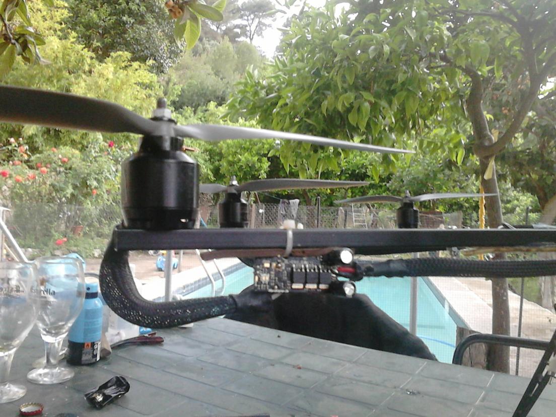

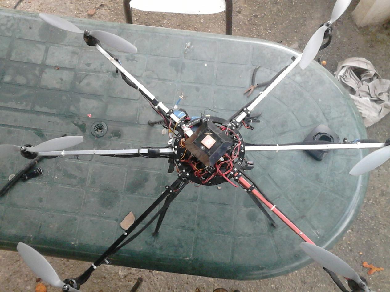

y actual frame is a bit customized, Im posting a pic here,this shape is very eficient and you get good prop clearence moving forwardsView attachment 18239View attachment 18240
Also adapting the BL under the prop wash diminishes the temperature , Im flying a sony CX730 and they dont go above 30C,it use to be 70C with the mk distribution board..

the rig I bought has the ESCs already soldered to the MK PDB - but I can see the advantage of the cooling out on the boom. So you add caps to the wires for running the ESC - PDB longer? That seems to be a debate that's coming up quote a bit lately.

I don´t use PDB, I solder all reds,all blacks, all C and all D and straigh to the FC & battery.
If the props and motors are balanced you shouldn't get any vibes on the image¡
Dunno what the debate is about but since I've rigged the bl's like this I've had 0 IC2 problems and the temp,the temp are magic under the boom¡ the condensator legs must be all the way through with a bit of glue under,I use gun glue.
For the shape you will need okto central plates in order to use these angles..
