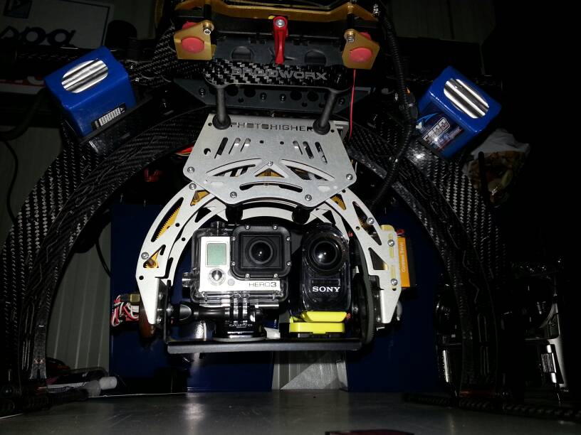

Got my micro sd cards today so can do a test. The hero 3 black is obviously going to win on compression, but the Sony may be better in other areas. Let me test.

did some flights that the discovery wore both cameras to the same parade and i posted the vids. I've flown the as10 alot, been on my disco since it got here.
as10
this is two different craft, but same spot one flight after another. This is the favorite job for as10, but the hero aint bad

The sony is over saturated in color. Sometimes it looks good, but it never looks like it did to the naked eye when you were there. There hero is a dead ringer.
The IS in the as10 never worked for me. it just makes jello no matter what. It's nothing like IOS in the nex linemore hero2 protune
