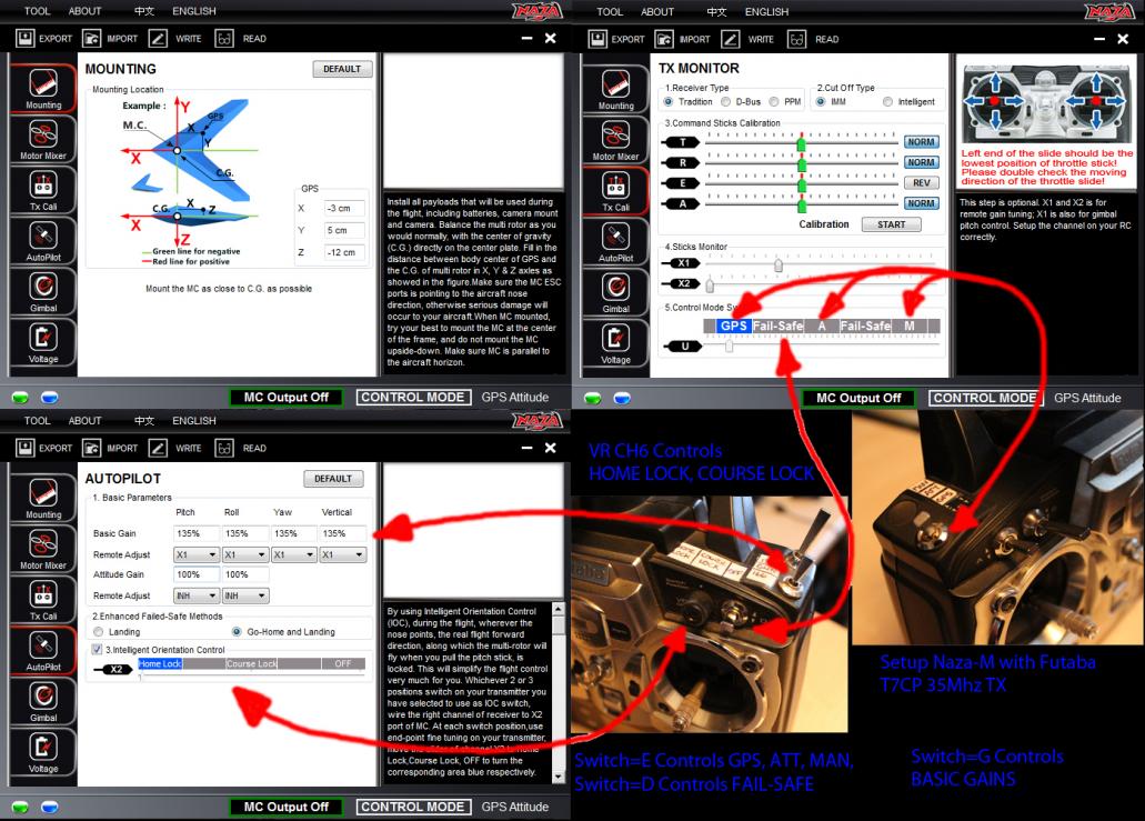

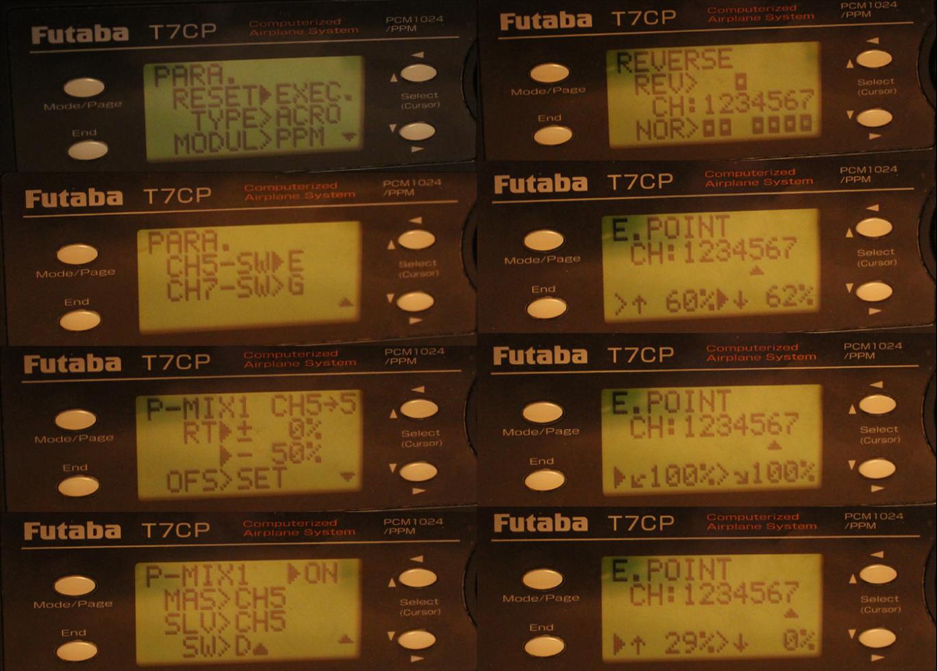

hia all,
can anyone help me with the setup of a futaba T7CP and setting the failsafe up.
ive seen this video http://www.youtube.com/watch?v=FsFUYeRz3Eo with it setup but ive been trying to get this to work
for hrs now and just can not sort it.
i have GPS, ATT, MAN, setup on the E = switch but just dont no how to setup the D = switch like he has done in the video
any help or suggestions on how to get this working
plus i have the futaba T7CP setup as PPM and in the naza assistant i have it set as Tradition and all works fine
but if i set it to PPM in naza assistant i get a RX-ERR dont no if thats right or not.

zx12rcarl
Hia gtranquilla
I've not got any probs with motors starting on my naza
I have all the command sticks in Green and all working
I have a 3 way switch setup with GPS, A, and M, and all working
And I can enable motors and fly my hex.
What I'm trying to do is setup failsafe on a switch on my futaba t7cp so if I'm flying around... I can flip
The switch and my hex will come back to the takeoff spot and land useing the gps.
