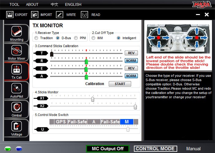

I decided to just buy a DJI F450 frame for now. Tiger 2216 900kv motors and 40amp Maytech/ simon K flahsed ESC's. Built it friday and saturday ngiht. Bout 6 hrs as I shortened the motor cables and re-soldered all the bullets connectors.. Started with APC plastic props 10x4.5? I think.
Flew today for first time sans camera gimbal & camera. Used my 5000mah 4s batteries from my xy8. Got 18, 20, & 21 minutes on 3 batteries with just casual flying.
Got it dialed in pretty quick with the Naza M. Liking how it flies. Very pleased with the build and flight times. Will wait to see what I get with gopro3 and gimbal...
