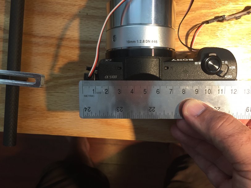

Can anyone help me identify the connector in the attached photograph?
It is rectangular with female two pin receptacles. On the top is a squeeze-type clip and on the bottom is a small fin about 1/8 in long.

looks like a JST but with a locking tab on there. JST's are normally red, FWIW
keensg
President, geoResource Technologies, Inc.
Not sure of the technical name - but it looks like the connector that immersionrc uses for their VTXs.
I think you are right! Thanks! Does anyone know what they are called and a supplier for replacement cables?
you can use a servo connector and just slice the third spot off of it. a little dab of hot glue will hold it in place. i'm pretty sure the spacing and size of the contacts are the same.
should work, at least until you can find the exact replacement connector.
