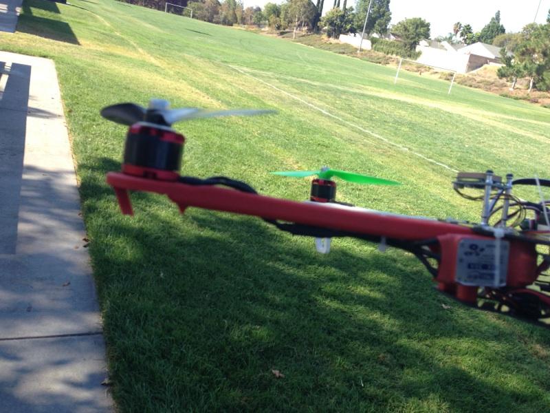

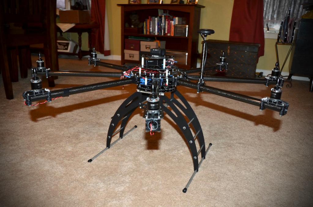

Ok, so I had this HF Pro (Green) board set up on a cheap frame and it worked very nicely without much effort at all.
Flew smooth as butter, AL worked and to be honest I never even tried AH.

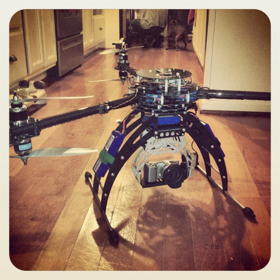

Anyways, I pulled the HFP board out of el cheapo and built a decent Y6 rig I built.

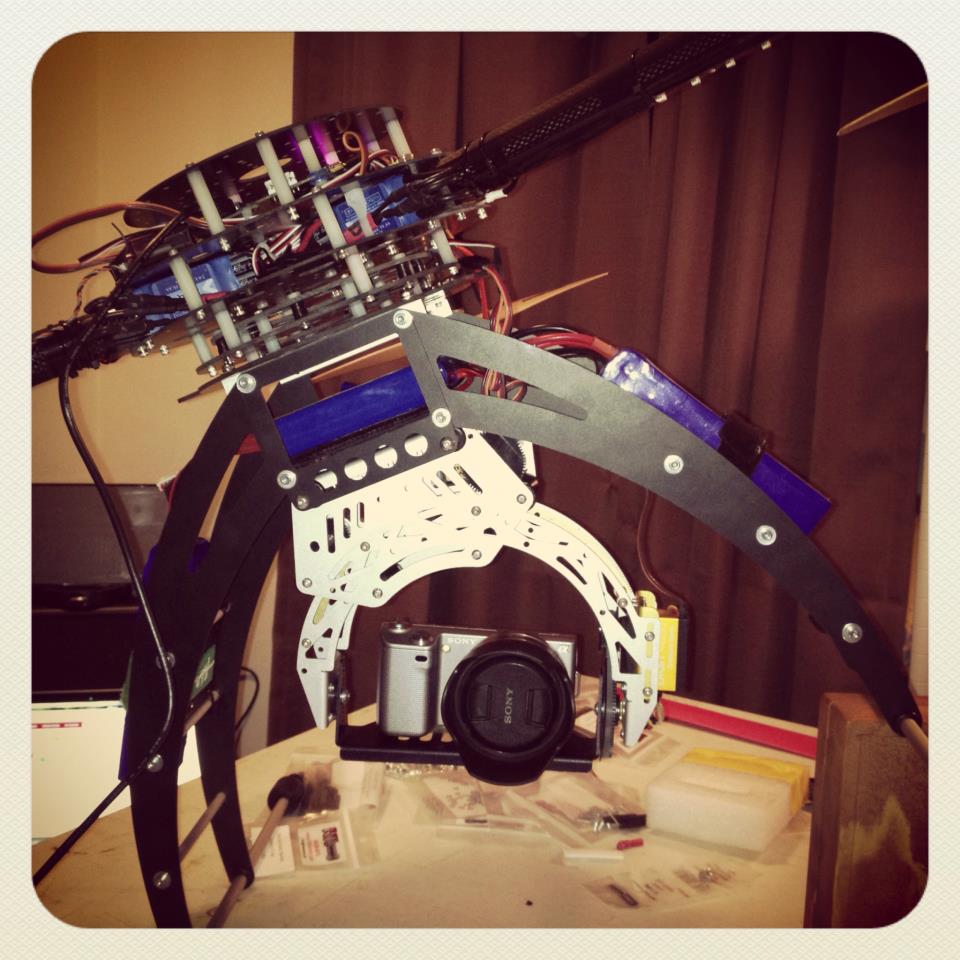

(Pics- First pic shows rig, I have since moved the batts to the main frame and off the gear,
and the second pic shows me setting up the gimbal. All was great!)
View attachment 10525View attachment 10526
It's a fairly big rig at 900mm motor to motor. 40amp ipeaka Simon K esc's with 750KV (big) Ipower motors,
spinning 12/4 wood Gemfan props on 4S with (2) 3500 packs that are brand new.
The HFP board has the power filter, and all the ESC power leads are pulled but 1 to power the rec through the board.
It's updated to 4.8 and I calibrated it. All checked out.
The rig flys great on Manual and I was starting to get the gain set perfectly. Yesterday Auto Level seemed to be going great as well it would be solid, but change a little Altitude when I hit the button ever so slightly.
So since everything was moving along nicely, I strapped on my AV130 and NEX5 and I was going to start the process of getting the vibes tuned out of the rig. I have one of Rusty's vib damping plates installed, and it takes some fiddling to get the right number of the M3 elastic bushings installed to get it all nice, nice and the rig footage ready.
I set up the gimbal last night in the HF set up client and in the workshop it was doing really well. Moving in the right directions, and was actually pretty stable on the first try.
I could rock and roll the rig and the cam was almost stationary.
Today I go out and its a crap day, gray skies, wind blowing 20+ MPH but I wanted to test this thing. (I have been flying airplanes for 20 years and helis for a few so I'm not really scared of wind) Anyways.. I take off and notice that the gimbal after a few moments seems to lose horizon a tad. Strange, but I figure I can tune AL a little before I try to figure that problem out.
I pop on AL and the rig drops the back rotors at 30 deg and takes off after me and the ground. My instincts take over and I flip back to manual and firewall the motors at the same time getting the thing level... right after this, the gimbal goes 30 deg to the right and around 20 deg up.. and remains there like that is the horizon. I land and am now sitting at home.

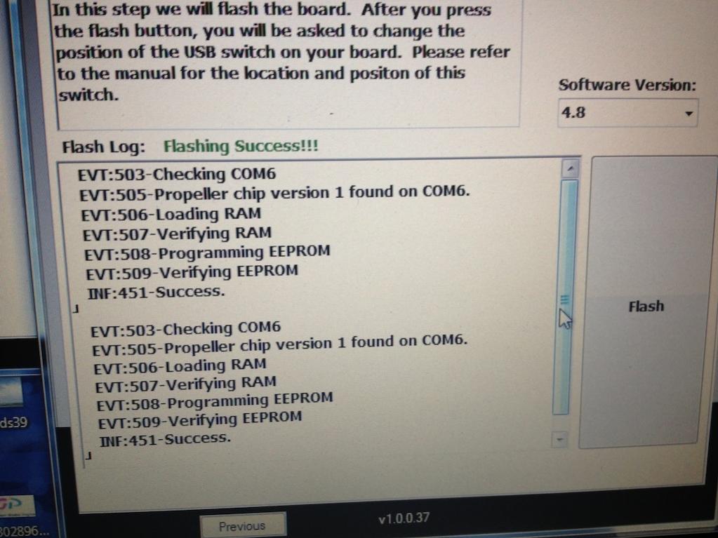

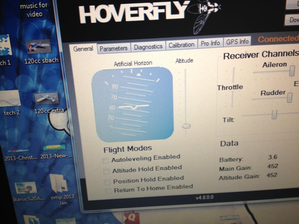

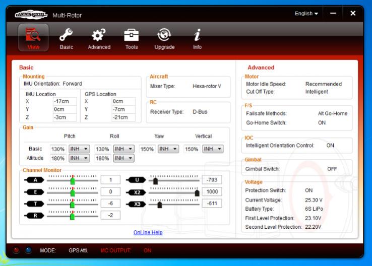

I re-flashed the new firmware 4.8 successfully as seen here:

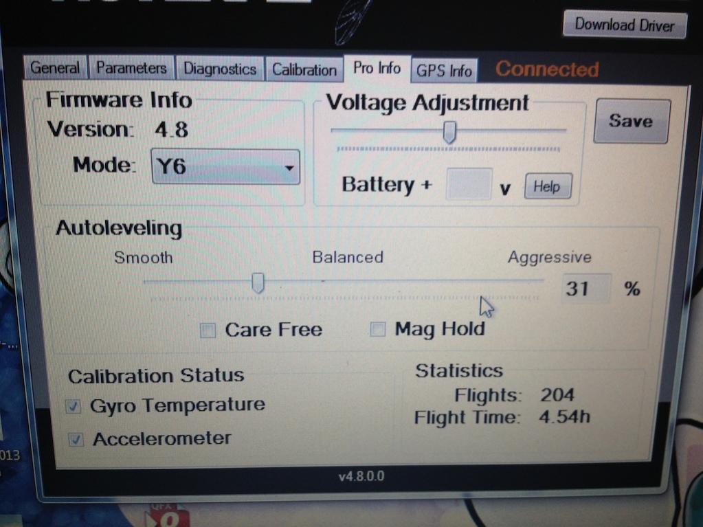

I then re did the calibration both gyro temperature and Accelerometer as seen checked here.
Also you can see the board is flashed with the new firmware:

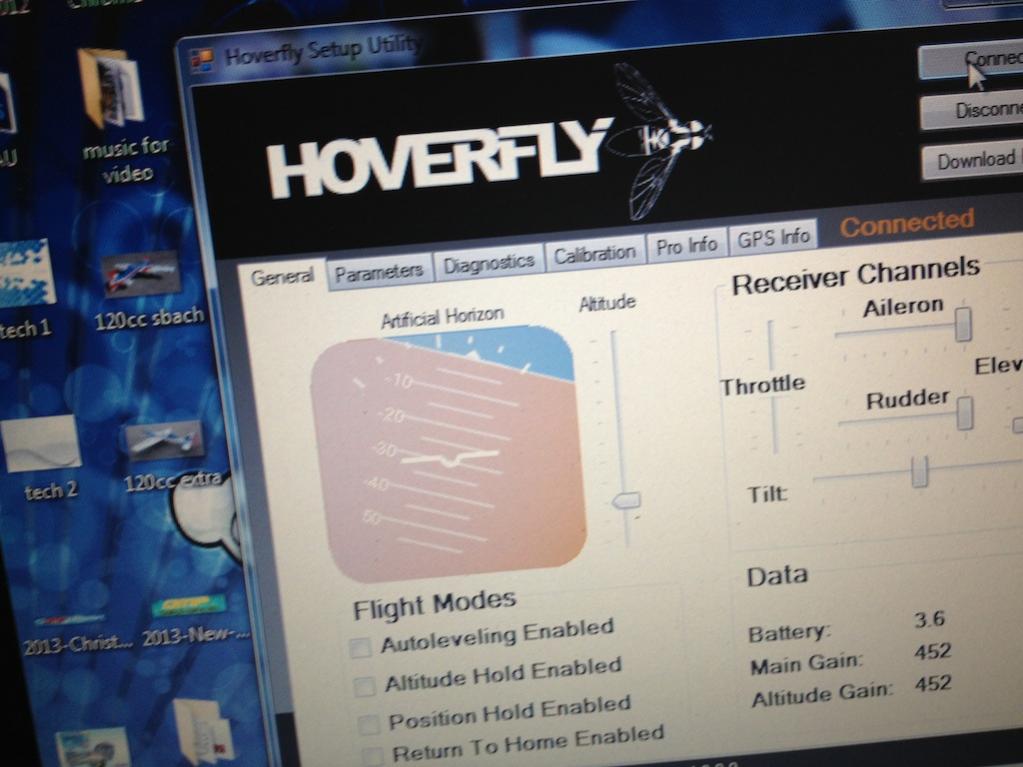

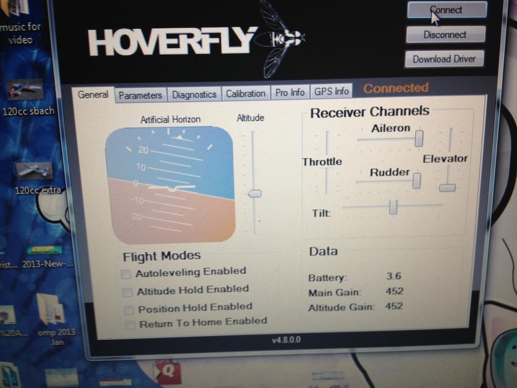

When I went to the general screen the horizon is all over the place.
And again, this is on BOTH of my green boards...
These pics are all within 5 seconds..
View attachment 10553View attachment 10556View attachment 10557View attachment 10558

Stacky
Ok, with respect to your rolling horizons, I have seen before but Im sorry I was unable to get any fix for that.
I think the best thing would be to send a ticket in to Hoverfly via the zendesk help section on their website. Include if possible a video of the horizon rolling or photos as you have done here. If you find a solution a local guy called Alan Henry here in NZ would be thrilled to find out about it, he has the same issue as you
View attachment 13521View attachment 13524View attachment 13525View attachment 13526

Ok , i followed the instructions exactly.
Erased the board. waited the 3 min between switching to pos 2, and 3 min after that.
I reflashed to 4.8. Disconnected the board from the usb cord waited 30 seconds and reconnected.
I redid the calibrations.
When i initially went to the General tab, the horizon started out at level and at 0. Then the horizon remained level for a while and the altitude slowly bounced down to -10, then-20, then -30 and finally kept bouncing from -30 to -50 and back.
It remained doing this for a min or so, and then the horizon went off about 5 deg to the right. At this point I picked the board up and moved it around, and the horizon seemed to follow, but when I placed it back to the level surface, the horizon stayed 10 deg off..
I'll try doing this to the other board tomorrow as I'm too tired to do it tonight.
I can take a video of it if need be just let me know.
