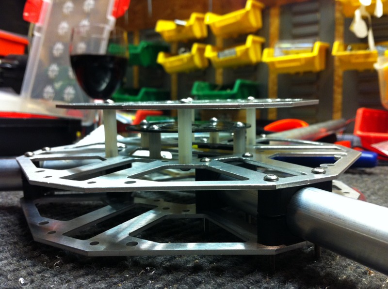

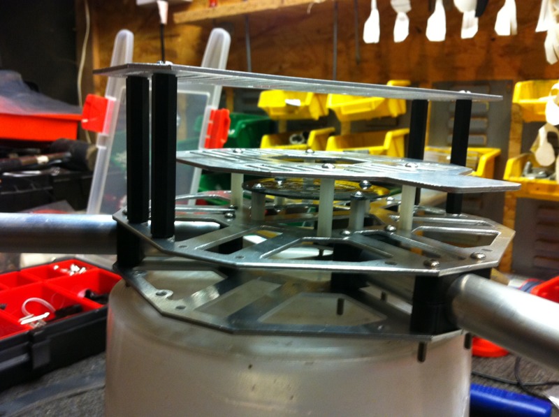

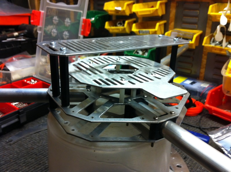

I picked up the new parts today. I hate the guy who does my laser cutting, I offered him money but he refused :)
A quick dry assembly before I deburr and send off for powder coating.

Dan, I'm deburring with a deburring tool and needle files in the smaller spaces...it must have taken me 2 or 3 hours in all!
