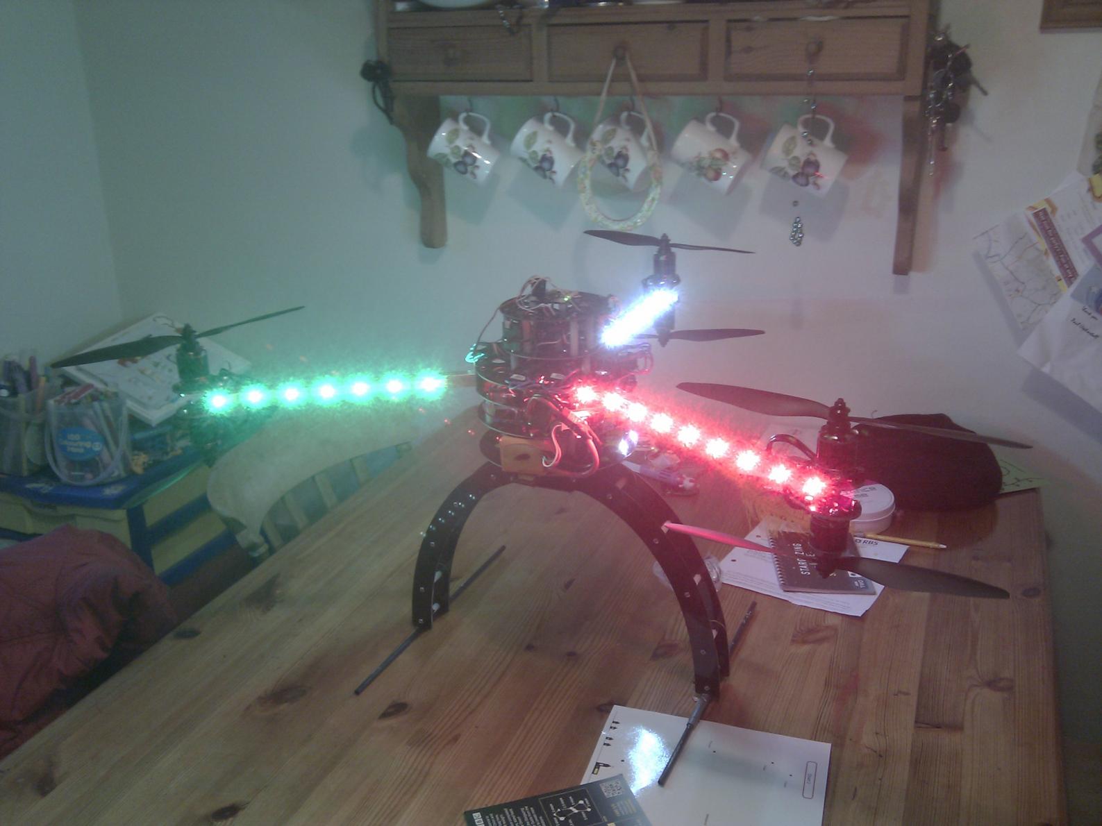

mbsteed
aerial video centric
Depends on the leds - I put my leds (turnigy) directly off my 45s batteries without a problem. I sense some can take this others probably can't.
Jake Bullit
Fly,crash,glue,repeat!
