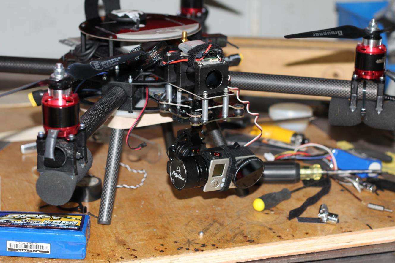

I'm in and built. Already crashed once :) Broke one arm just before the motor mount when I switched from ATTI to Manual without adding enough throttle. For you/us noobs, when hovering or flying level and you switch to manual -- add throttle first! Mine is the F450, stock DJI motors, NAZA V2/GPS. Pulse 4S 4100mAH. Trying the 8" and their 10" props and just experimented with some APC 9x4.7 props. Not sure about my conclusions yet, but I get just under 15 min. flying it modestly with a 90% charge using the 8" stock props and my total weight is 1688 grams. Futaba 8FG Super. Added two of the IrisAerial Batwings, one in front for the GoPro Hero2 and one in back for the GPS and to stick other stuff on.
After this photo I added the IrisAerial legs and have the GoPro hanging down now. Balance is better and the props are out of the view of the camera. The LEDs are single unit 9-LED 12v "corn lights" (371000030) powered by a UBEC (12V45AUBEC). Each draws 1.8 watts and I'm going to get smaller ones (maybe 5-LED). Each is mounted in a plug-in socket (371000075-0). Those are HobbyKing part numbers.
This photo was taken near dusk on an overcast day.
