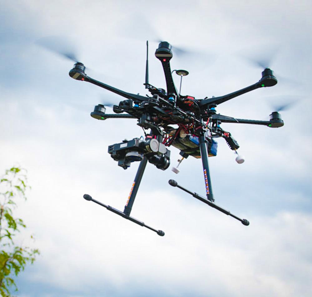

I've got a few for work. The idea was I cold use the S800 for film/photography and mapping but that isn't panning out with the short flight times. I ended up building a fixed wing (X8) with a custom roll gimbal, RDF900 modem, APM 2.5 and 10ah 4s batteries. It's the only way to get a good sized grid to map. I'd really like to setup a long range multi though, stripped down to the essentials just for photogrammetry. As for the S800 it's got the Zen gimbal/NEX7, second sight cam, 2 VTX's, LK900 modem, retracts, external data logger and two 6s 8ah batteries weighing in at 7.8kg. I'm going to be using the PX-4 autopilot for the new quad and maybe the new T-Motor U8 series motors with large props to push my flight times.View attachment 13330

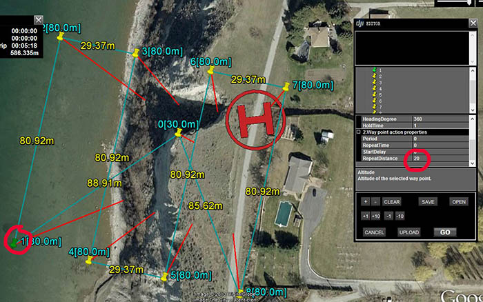

Well, if you can take a reference photo it should work... Unless you've set the servo to an extremely long delay. Pretty much any setting form 500, -500 to 900, -900 works with 1sec delay. What are you seeing in the editor and when you upload? When uploading you should see basically every second waypoint with an action set to meters. I'd screen shot it, but I'd have to power up the S800 (man, I hate having to do that). Also, in the editor you should see every odd waypoint with an action in meters in the repeat field. I attached a screen shot for a mapping job I'm doing tomorrow. I circled the waypoint and its repeating action in meters. In this case is 20m, but that depends on you overlap and altitude. At least you can check these settings with yours.

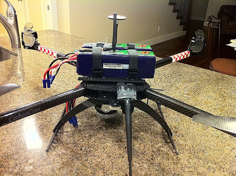

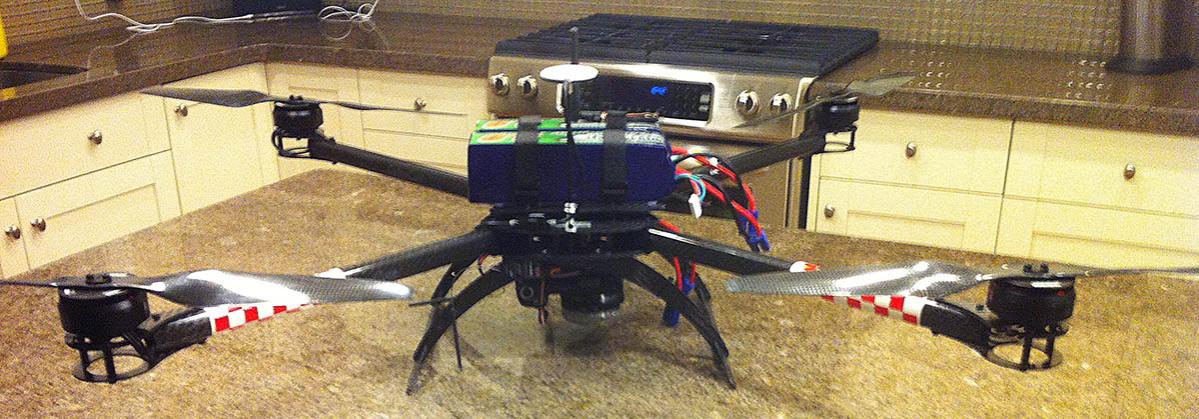

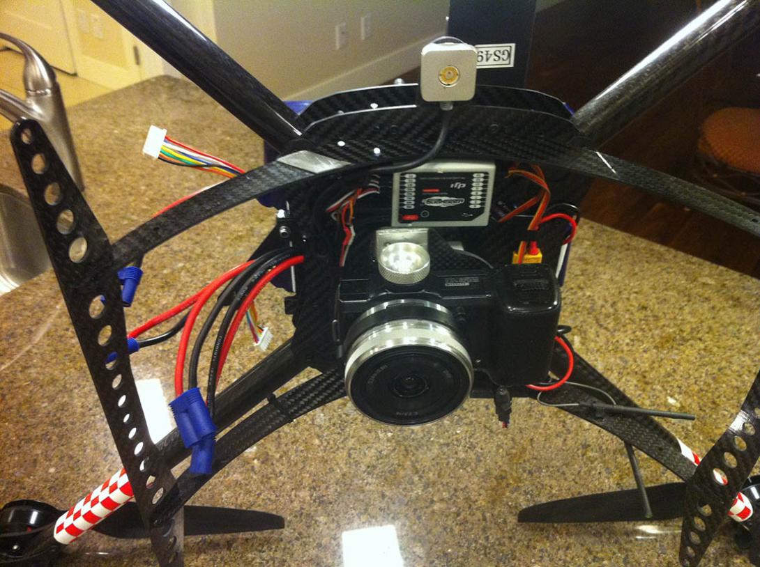

It's a quad but I cheaped out a bit. I used the 950 frame with Foxtech 6135-330 motors and 18" props instead of the U8's and 26" props. Save quite a bit of money over the U8 setup. I'd love to see what's possible with the U8 setup, but I'm getting a solid 40min with a full payload (Sony NEX5n). Still using DJI WKm with a LK900 modem, but I'll try swapping it for a new Pixhawk and a RDF900 modem. I've got modems, but it seems the Pixhawks won't be shipping for another week or two.
