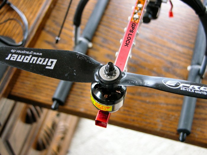

Buzzed
Update: Here's a picture of the Graupner prop mounted with the stainless steel fender washer. McMaster-Carr offer fender washers in various diameters and with various sized holes. Part number 91116A140 has a 5.3mm bore and is 15mm in diameter. They come in a bag of 100 (life's supply) for $5.71
Maybe this will help some of you guys with the same problem.

I haven't yet had this problem as usually the prop adaptors I buy come with the washer and I've been fortunate that the motors I've bought also came with washers for the prop adpators. In the few instances where I don't have a washer or would prefer something that looks a bit nicer than a nut and lockwasher, I use these... http://www.allerc.com/hyperion-bull....html?osCsid=763b39492672725c032335a73e66a2d0
Yes they cost more than a simple washer but they look better and with a tiny drop of blue locktite do the job of both wwasher and locknut. Sometimes I use them with a washer if the adaptor they're going on happened to already have one as in the pic below...
