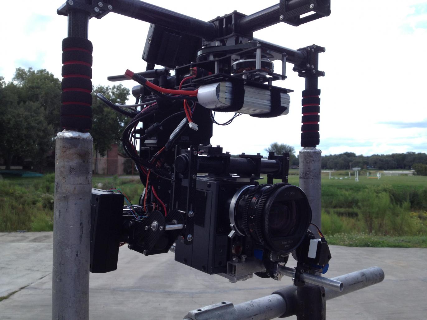

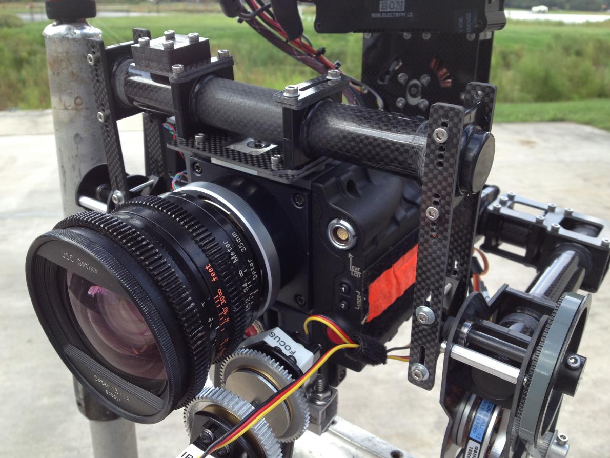

RC Rotors
You can also go this route. assembly comes with a clutch system so it wont ruin your stops.
