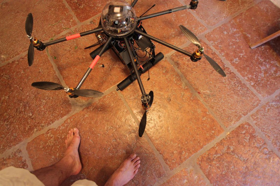

Gonna cry for a week !
BorisS
if it's any consolation, the rebuild goes more quickly than the original build.
sorry to see it happen to you.
let us know how we can help :)
bart
BorisS
Thanks Bart !
Already cooled down. I need a good reseller or direct link to spare parts. I can't deal with a 3 weeks waiting procedure everytime I need something. Any links direction you guys can guide me towards.
Thanks Boris
NO NO NO NO NO NO!.. I hate seeing these I will be having nightmares again!
WTF happened..
Make a list of parts ASAP.. does KW not keep spares?
DAve

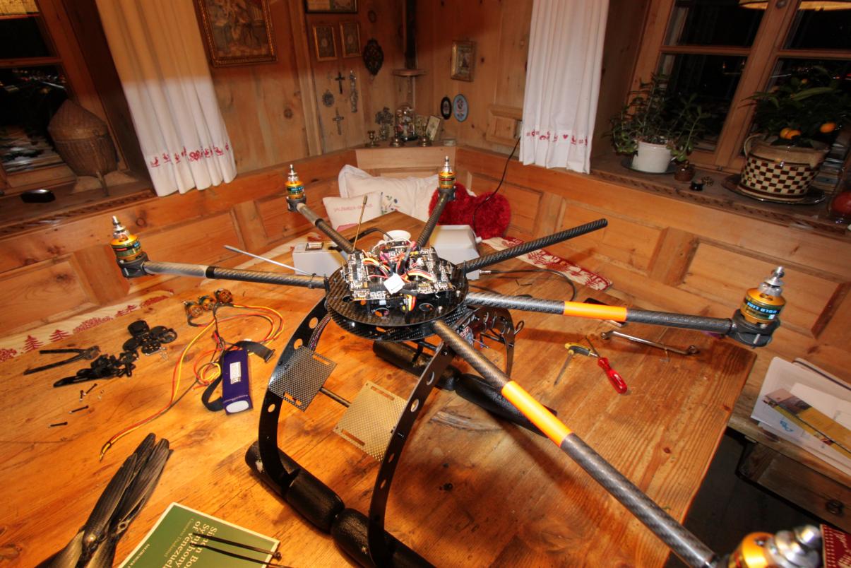

BorisS
nope nope the AV 200 got a punch an the roll axis plates are bent, but only one of them ! I think one of the broken of booms hit it.
Status,
2 Booms broken. not totally sure didnt look under the dist board yet, if the others are okay
1 Mounting plate broken, motor broken off.
PH got a punch didnt inspect it closely yet hope thats it !
Not sure about the motors yet three of them could be gone !
Luckily no ic2 error in the MK tool, boards seem to be okay hope hope hope !
Resumee Im just an arse ! Took it on a wide yaw turn trying to make it as smooth as possible to check if the PH / Setup improved. Got to close to the trees freaked ( wasnt close to the state were i should have been flying over nighted, first day stop smoking attempt, like in clouds ) brain snapped switch in the head left is right and forward is back didn´t work (wait i did turn with it should be right), took it to the ground before hitting the trees.
Trying to take the possibly broken motors and broken booms off now without desoldering the whole damm dist board. For the new hexa I am going to rethink the whole setup, although thinking about that makes no sense this wreckage will set it back months.
KW is on vacation till the 8th of august, plus the store has none of the parts in stock. Cant deal with the items being shipped to KW first than to me etc. Might just order over the us store, although i cant deduct tax over my company. hmmm
Have it all on HD :) just cant watch it !!! Might post it later in embarrassment and if my humor returns to its max.

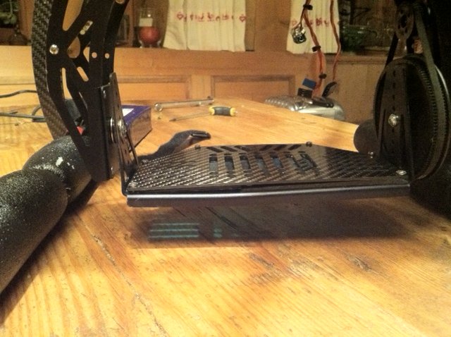

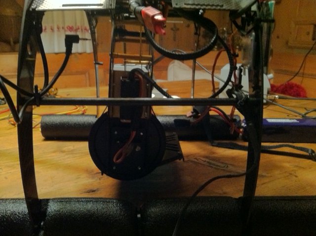

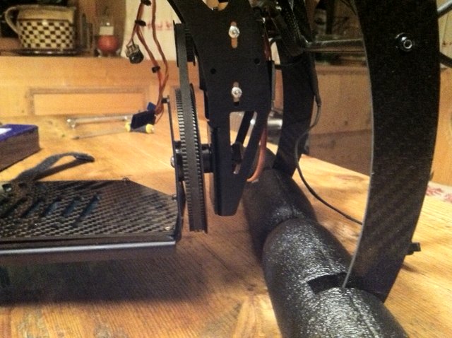

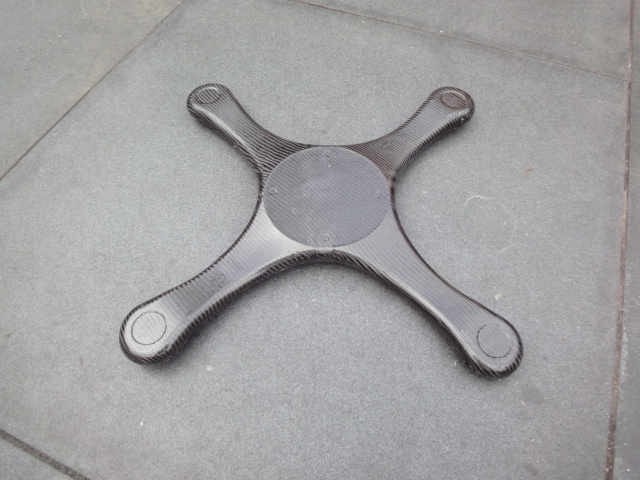

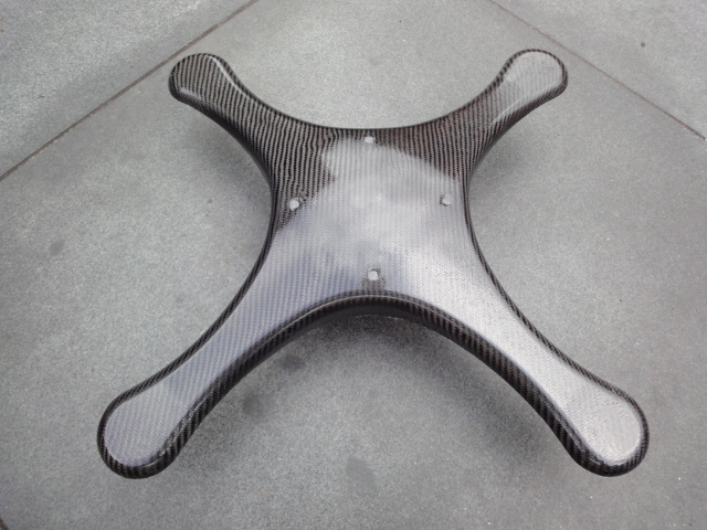

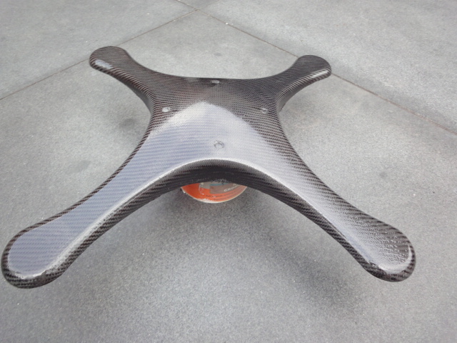

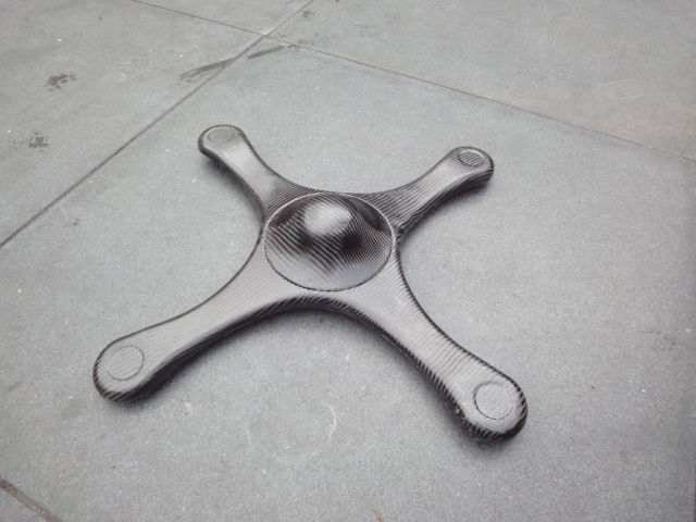

Bad news AV 200 is more damage than i thought.
Its bent from head to toe, Funny how i havent even checked my camera and dont really care.
strange that they are upside down :)

Ill post a picture of the spares i have.. it is the whole cage and camera plate.
Sorry buddy.. OMO it aint worth trying to rebuild with out a total strip down.. I did it and tried to mke it better by only half looking at it.. My ADX flew for the first time correctly tonight.. almost 6 weeks after my crash and a whole load of wedge and heart ache!

@Dave, if you can help me out on the AV 200 and we can arrange something i would be super happy. The AV 200 is my biggest worry and with the parts i have now bent a rebuild is not possible. The metal just softens out at the spots were its already bent in to shape.

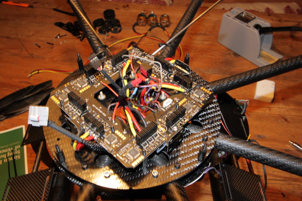

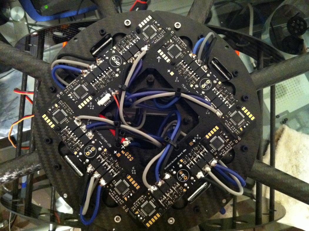

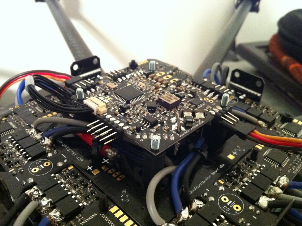

I stripped it down to this stage now, but following your posts you had to disassemble the whole distribution board and test every BLC ?
dont comment on the decoration in that room its my mothers counrtyside austrian farm house room

Take photos of everything you do and I would recommend you start writing down your every move, mark up your motor wires and which pads they are soldered to. Also check the way the BL's have ben allocated.. It does not alsows mean thet BL 1 is in the BL1 slot on the distribution board. I have found this invaluable.
I have amople supplies of silicone wire, that black mesh sleeving and more shrink wrap that you can shake a stich at. I have also found that buying a cheap soldering iron is false econnomy. You need one capable of 80 watts .. no less and with a selection of tips from 4mm chisel to needle point.
If the ids board is not throwing any errors dont touch it.. but buy a jewellers eye glass and check every BL VERY carefully.
