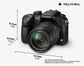

new Panasonic GH4 into Z15 GH3 Gimbal?....
Hi all, can anyone in the whole world please please confirm if the new GH4 body will fit, and work ok inside the GH3 gimbal please?
View attachment 18328View attachment 18329
I'm speaking to main suppliers in the UK, main ones, some are saying it will, some are saying there unsure, but is there any forum members outside the UK who might of actually seen it, done it and know for sure if it will, please?

Easy? You call that easy?
It should. It's only 1.9mm deeper but that is the easiest axis to balance on the Zen. I'm not sure if you can record in 4K and output HDMI in 1080i at the same time, but that's another question.
Mick Koi
that definitely is another question Ben, one which i hadn't anticipated :disturbed: and i suppose won't be answered until its mounted and running through a lightbridge, fingers crossed that it will. yes the dimensions difference is minimal, Iv purposefully left the gimbal out until now to see if the camera will fit, so upto the shop on tuesday morning for the fitting, and if it doesn't well the GH4 will be going straight back, then back to the drawing board...
