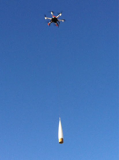

See photo below...... HAM Handheld used to gather the rocket nosecone beacon GPS location.
Also here is where I took my course.... thought it would take 2 or 3 days..... try 2 to 3 months!!!
http://www.hamradiolicenseexam.com/

Looks neat! Can you better explain what your doing there? Not sure I am understanding.

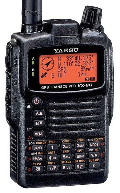

The course can be as short as 2 to 3 weeks (2 night per week in your local area).
GPS rocket beacon is: http://www.bigredbee.com/BeeLineGPS.htm (70 cm is in the 400 Mhz HAM radio frequency band)
My handheld HAM radio c/w GPS tracking via APRS: see attached photo....View attachment 17556

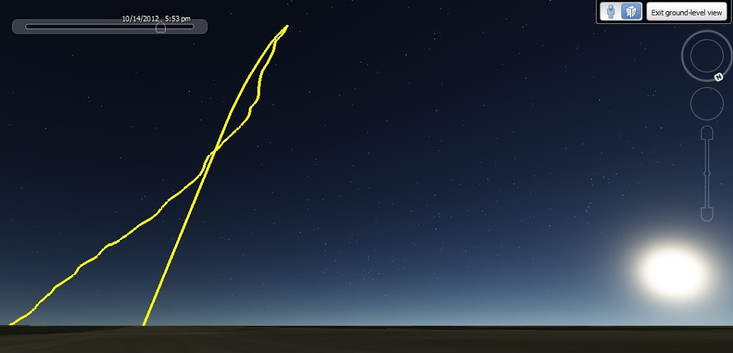

Here is what one of my high altitude rocket flight looks like after the GPS kml file is loaded in to Google Earth..... same can be done with Multirotors..... now lets get back to Multirotors!!!
