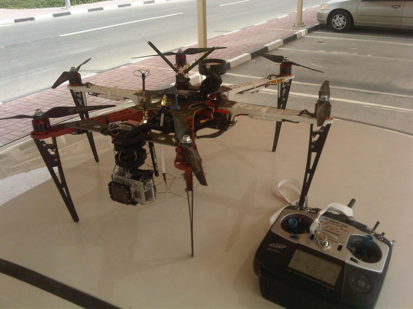

I run 5.8 and 1.3 simultaneously on my 550 and as posted about the only solution was to keep moving the GPS higher and higher until you can get lock. Also shielded GPS with copper tape, Shield Gopro with copper tape and tried to get as much physical separation from all components.
