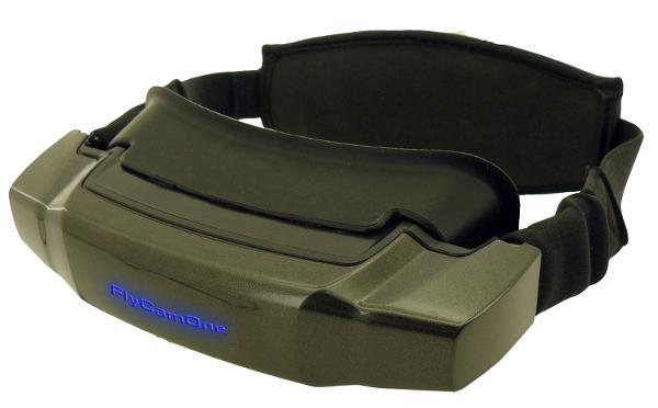

FLYCAMONE HD V-EYES 720P/1080P INC INTERNAL 433MHZ SENDER AND AV-IN IPHONE / anyone ?

The big problem I see is if you want to use long range radio gear like the EZUHF, also using 433 mHz. The other thing is there aren't any video TX that can transmit HD video streams so while you may see a somewhat better picture than with other setups it won't be true HD.

I got the Flycamone HD V-Eyes and I am happy with it. Don't know how fit you are with FPV, so I explain a liitle more detailed: The 433Mhz sender is just the signal for the head-tracker (if you use the Flycamone HD 1080 camera, you can move the cameras optic by just moving your head) , but instead of the 433Mhz signal you can also use the trainer port on your transmitter to get the signal up to the camera. For video transmission you need either the 2.4Ghz or the 5.8 Ghz transmission set. The Flycamone HD V-Eyes comes with some sort of baseplate, where you hook up the receiver of your video transmission. What I really like about the Flycamone stuff is that there are various modules which are all plug and play. I have replaced the rubber duck antennas with cloverleaf antennas on end and a circular polarized antenna on my ground station.

Thanks you guys for looking and your comments, ChrisviperM, just curious here - I guess one can use any 2.4 / 5.8Ghz system here, not necessarily the Flycamone units ?
Wondering how they would compare with the FatShark Dominators
