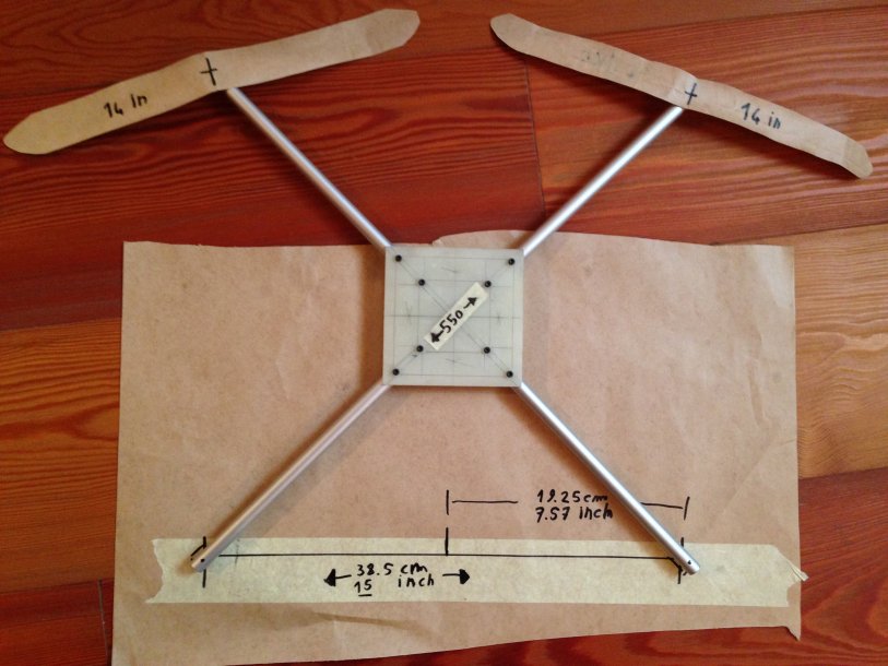

Just measured... look the photo
Okay maybe 14 inch props are a little bit oversized;) but a 12 inch prop fits very well.
Or in future I can stretch the alu tubes.

eskil23
Wikipedia Photographer
Obviously it was more than just the homemade part I missed. I'll be quiet from now on.
PeteDee
Mr take no prisoners!
Will also depend on how you make your motor mounting plate and how it mounts, may even be able to sneak in 15 inch props.... ;-)
