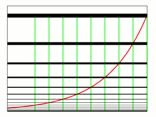

crayfellow
Sorry, expo is short for exponential. Think of a set of numbers. A linear set (a straight line) would be 1,2,3,4,5, ... an example of an exponential set would be 2, 4, 8, 16, 32, ...
So as you move the stick on your transmitter, it's following some function in the way it affects the movement of your craft. At the very least, the transmitter (the sticks you are moving), flight controller, and ESC's are all impacting this.
"High" expo would be a very bent curve, where you might move the stick 50% or more to the limit, but the impact to the desired throttle, roll, pitch, or yaw are very small. But move closer to the extremes, and the impact becomes 'exponentially' extreme.
So you'd want to check your expo settings on the transmitter as well as the flight controller in order to truly understand what to expect from the craft. You might try hovering in a SAFE, CONTROLLED, OPEN ENVIRONMENT, then test a small roll/pitch to confirm a small response, then try (for example) moving roll or pitch to ever greater extremes, slowly back and forth to keep it generally in the same hover location. If your expo setting is to extreme for your desires, you should find an exponentially more significant reaction as you get closer to the extremes with your stick inputs.
