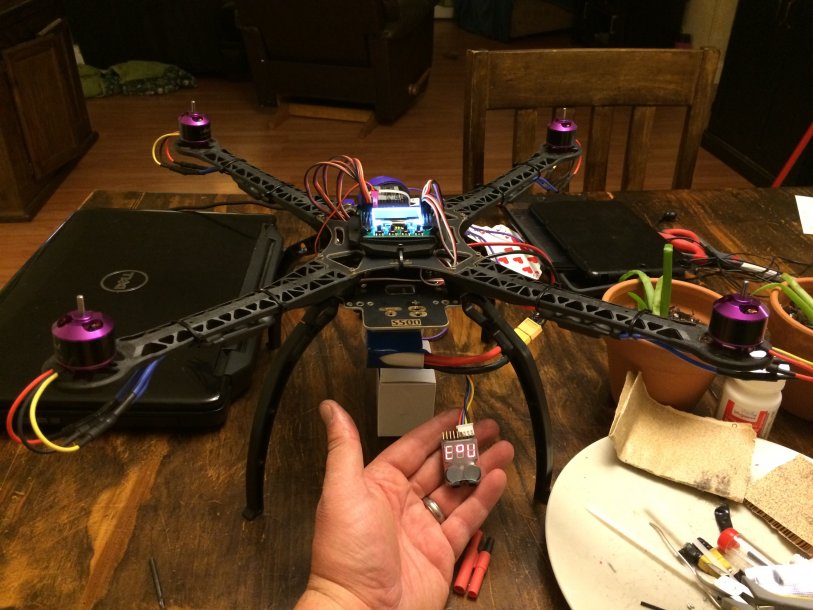

Good day! My son and I built a quad from an ebay seller. S500, kk2.1.5, 30a ESC, 980kV motors. It is built I just cannot for the life of me get it to fly. When it goes to take off if will just flip over. Who can help. I have checked the obvious stuff many times. How do I know for sure I do not have a defective board or ESC??

Thanks for the reply. I have tripple checked those items. I'll try to upload some pics and video.

Your video says its private and could you attach your props to your Quadcopter and show the front and the rear? Thanks
I saw your video If you look real close the front left motor (CCW, as the quad is facing you) seems to start late compared to the other three motors. Did you throttle calibrate your ESC's through your radio's receiver? (don't hook it up to the FC, but hook each esc directly to channel three of your recever . Then turn your radio on , put the throttle to high and power up the receiver. you'll hear a beep (indicating the high throttle limit set). then put the throttle down to low. You'll hear a beep (indicating the low setting set up).

I tried to calibrate the ESCs a few times again with no luck. I tried it through the kk2 board and I tried to do it one at a time through channel 3 if the receiver. It appears to work, just doents have any effect on it's flight. I'm going to be posting videos about my tight motors. Please take a look and let me know what you think.
jinly
The motors should NOT be tight like that. Brushless motors should spin freely. If you have to move them about to get them to spin freely. I think you have bad motors. What kind are they? If it was my "build." I would buy different motors. Look for quality ones like Sunnysky Brand. Which I use. I like them because they are pretty reliable. I wouldn't trust motors that may seize up in the air. Obviously they aren't getting your "rig" in the air. To be safe , switch them out. Ask the Forum what Brand of motors people like.
