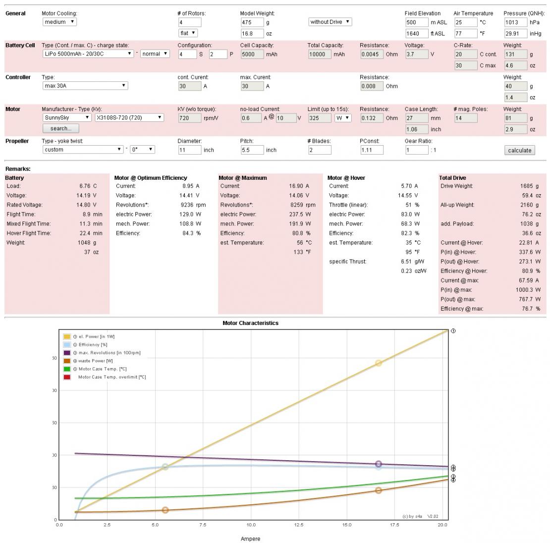

The SunnySky x3108S 720KV motor is looking good but I'm having a hard time finding a battery and propellers to match, one small change makes all the values change so drastically :upset: in eCalc I'm using 11x4.7 at the moment but I'm guessing I would need slightly larger? You are also right about the costs, that shocked me quite a bit xD although there are some cheaper carbon fiber props on ebay (new). The flight time is also very low (under 10 mins) which is worrying me. Would I need a second battery pack for longer flight times?
eCalc:
http://www.ecalc.ch/xcoptercalc.php...11&proptwist=0&diameter=11&pitch=4.7&blades=2
Motopreserve
I don't know if it's the mobile device messing up the link - but the eCalc just takes me to a blank page (very annoying - since I paid for it!).
What so you mean hard time finding battery/props to match? In eCalc? It's just a guide anyway, so don't worry too much about the times. Sometimes they are scary accurate - other times they've been off my 10 minutes. Pick a 4S, say 5000mah battery at 35c (can be less if you can find them). You will want a few. The 11x4.7 will give you about enough lift for a basic build. Moving up to 12" would give you some additional payload.

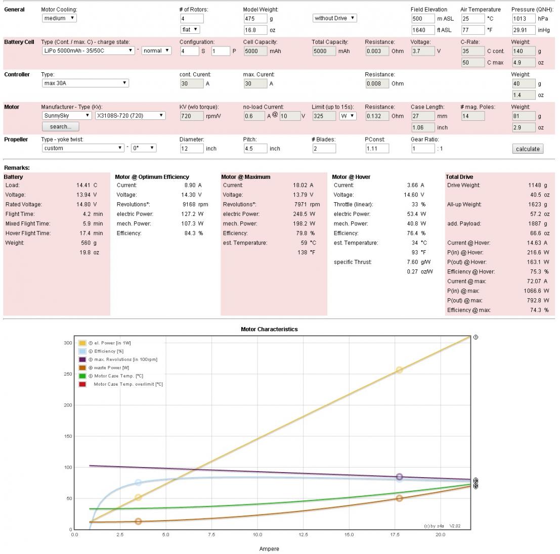

Those numbers look great. And of course you can always change the size of the props a bit for different lift/efficiency etc. the only suggestions is make is to maybe up the ESC to 30A or more. Size/weight/cost will be minimal and give you a little more headroom and keep them cool. This can prevent heat - which on these systems is translated to loss, and potentially lost flight time.
Also, the batteries you should be looking at are about 35C. They can be less, but you definitely won't need more.

For the propeller I think ill go for a 12/5.5 CF (some are not bad prices at all)
All this gives a lower hover throttle at 30% though, not sure if this is ok, but everything else seems to look good. Here is the eCalc sheet for it:

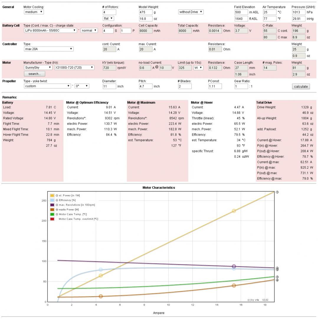

30% is way too low. You need to add weight or find more appropriate props/motors.

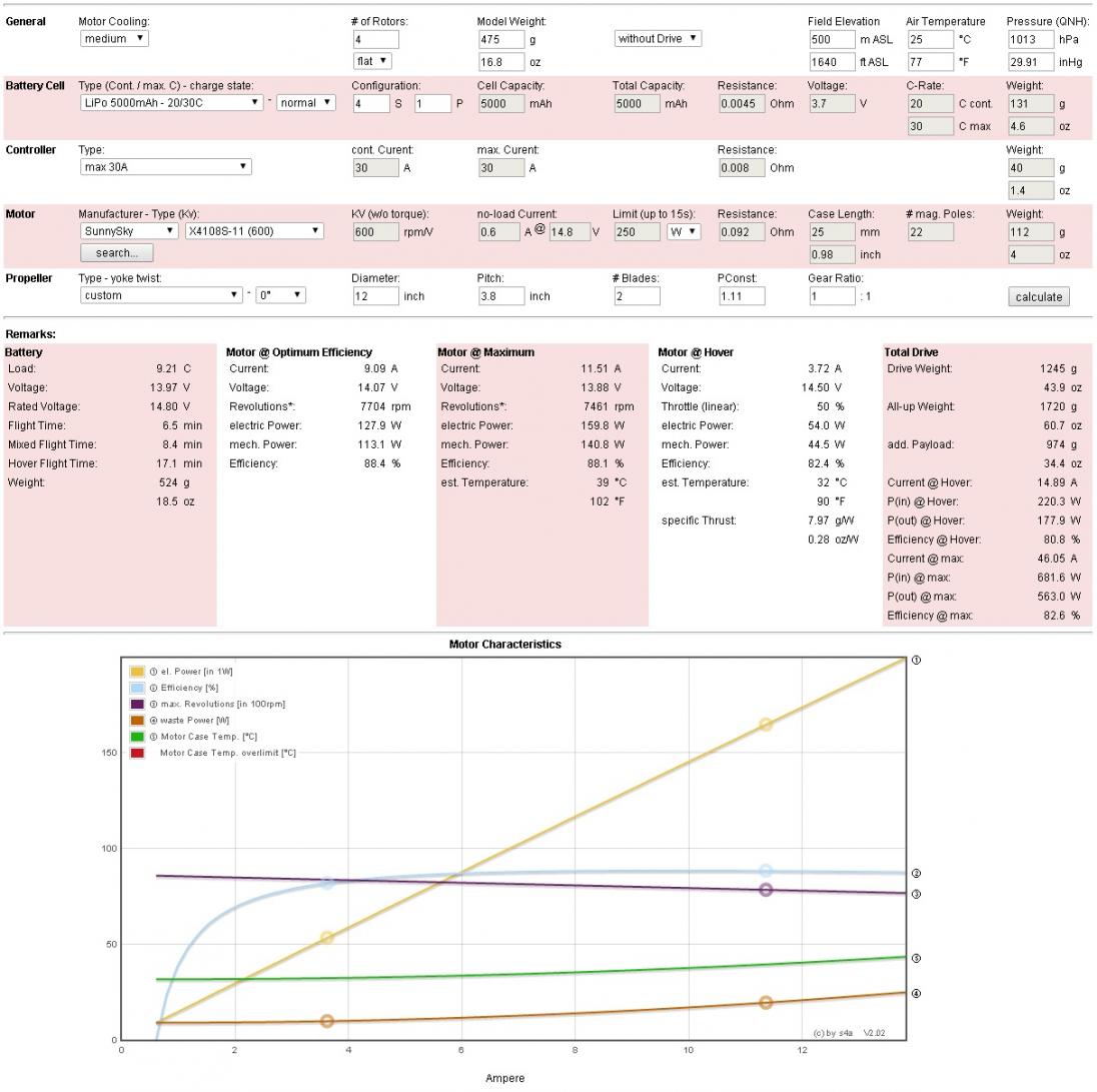

Maybe something like this? its 51% with longer flight time now.

Those numbers are looking mighty fine. Ideally you'd be at 50% with one battery, unless you plan to run 2 every time. Just means you'll want more batteries. :)
