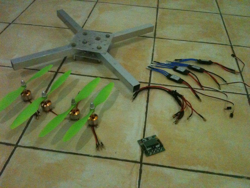

please excuse the quality of the pictures it is the best I can do at the moment.
I have not connected everything yet since I am still thinking about what changes that I need to make .
One of my biggest problems at the moment is mounting the Flight control board. and what is the best way since I need it to work perfectly .
my Second problem is calculating my thrust exactly. I have spent countless hours searching without finding a good scientific way to calculate it. take into consideration I am an aerospace engineering student (one would think this would be easy for me).

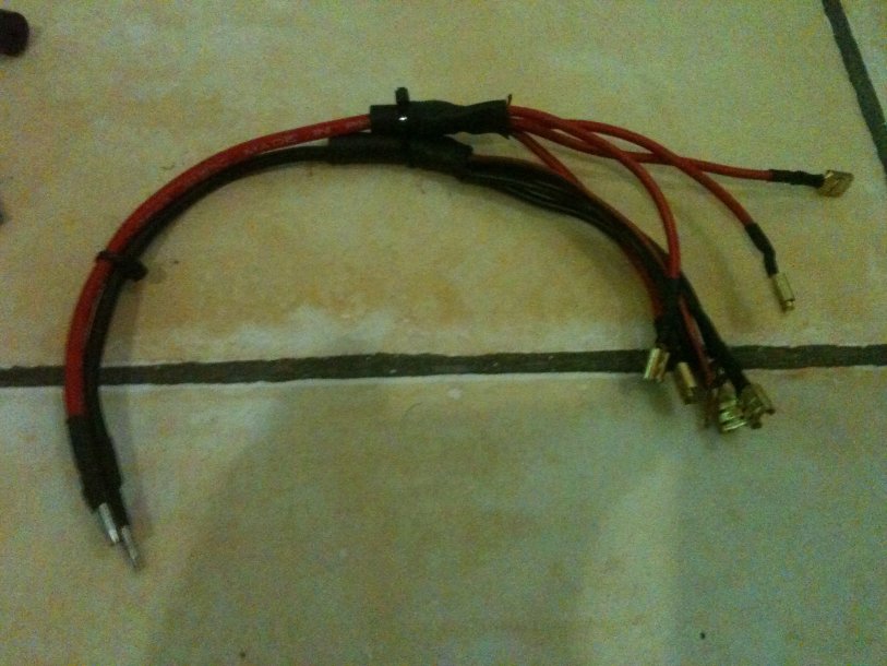

Pictures are bellow one of the whole set and the 2nd one is for the power distribute (to get feed back about it mainly)View attachment 23890 View attachment 23891

That's not ugly! It's gorgeous in the best DIY way! :)
