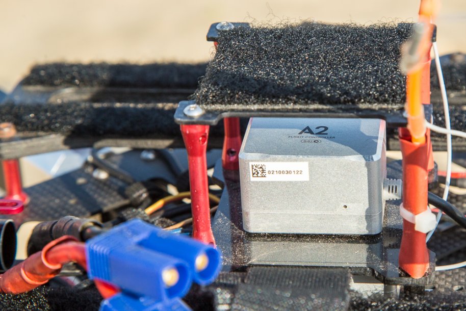

SleepyC
www.AirHeadMedia.com
SleepyC - are these yours our Tom's? Would like to know which KDE motors on the smaller rig and what brand CF props those are? I don't recognize the logo on the tip.
Those are Toms. My rig has Avroto 3515's. (Avroto IMO make some of the best motors out there)
