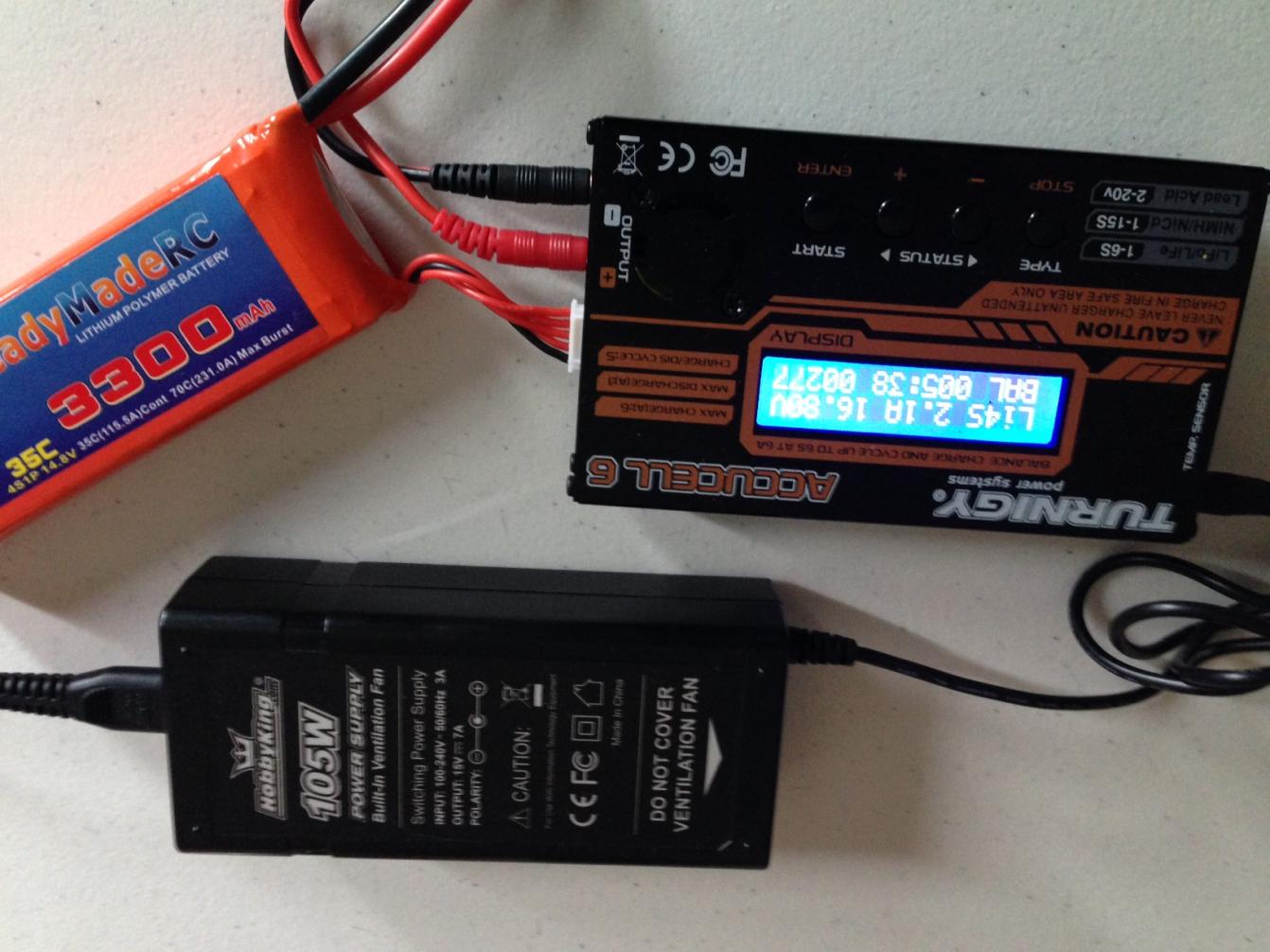

My battery is only 14.8v does this make any difference?
I'm charging on balance mode Li4s 3.3A 14.8v. Just flew and I'm reading 15.50v as soon as I plugged it in to charge
4cells x 3.7v (nominal) = 14.8

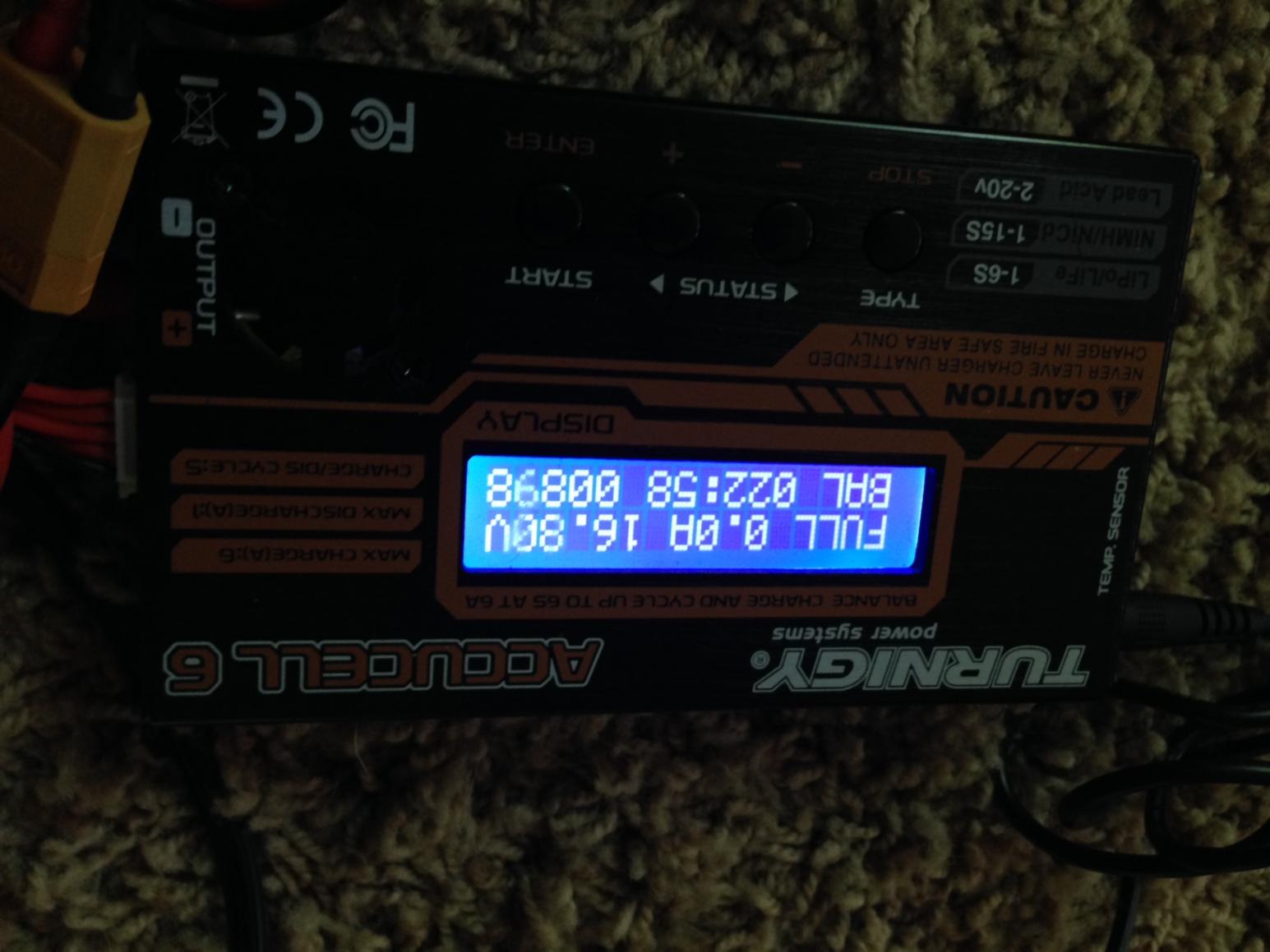

Here's a picture of my charger. So is this about full? My amps dropped from 3.3 to 2.0 while it was charging, trying to comprehend..lol
(I PRE-rotated this picture multiple times and still, it uploads upside down, sorry folks)

The amps listed on the charger show the amps it's using from the power supply to put juice back in the battery. For a 3300mah battery, if you have it at 3.3A (which I think you did), it would be charging at 1C rate. That's the safest for the life of the battery (open to interpretation - but definitely a safe charge rate).
When it gets to the end of the charge you will notice the amps will get very low, that's when it's trickling it in to balance the cells.
The number on the lower right of the actual charger - not your upside down photo :) is the mah being put back into the battery. Based on a 3300mah battery, you should never be putting in more than 2640. That would be the 80% rule.

So I plugged my battery back in to balance charge after my LED was blinking during flight (GPS was good, guessing battery voltage). After doing the calculations In Bart's thread. (If I'm correct) I only used 27% of my battery. hmm
Only took me 22min to charge back to full, that seems a little quick though. Put 898 back into the battery. Guessing I wasn't THAT low in the first place. Odd
