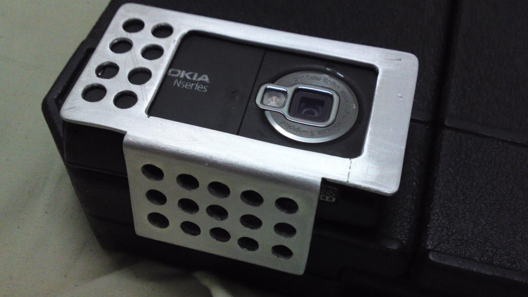

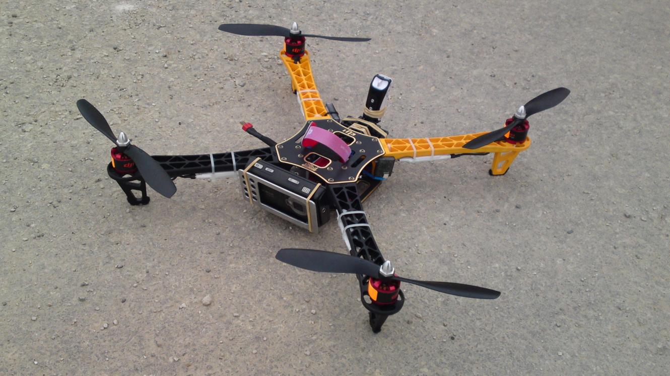

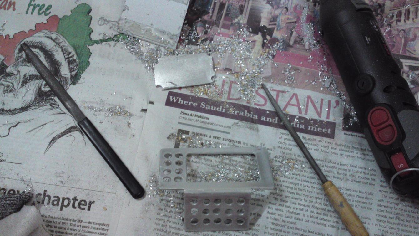

Here's what i did on my 450 for my old junk Nokia n95 phone, it takes on the ixus 220 with no probs but just picked the phone so i can just do anything with it with no worries... just fabricate a mount out of 2mm alum plate... the total setup with velcro is 28gms... i also tried the Hobbyking LG with camera mount and just having hard time with the extra drag with the winds where i fly, additionally with no extra LG or Cam mount i can just toss the f450 in the booth and makes it more portable.
