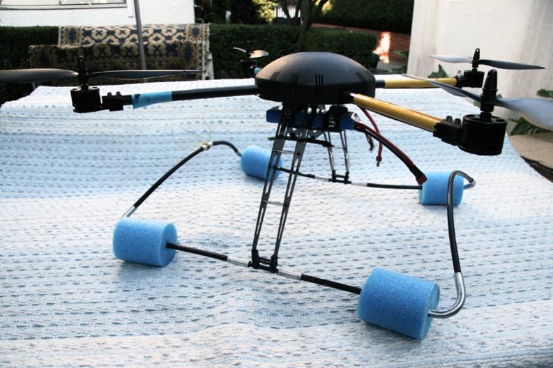

Hi again,
As I promised, here is the landing gear modification I came up with, after rejecting a lot of versions. I hope it will last longer.
And it waights 93 g. This can still be reduced optimizing the design and the materials.
Please commentView attachment 633
