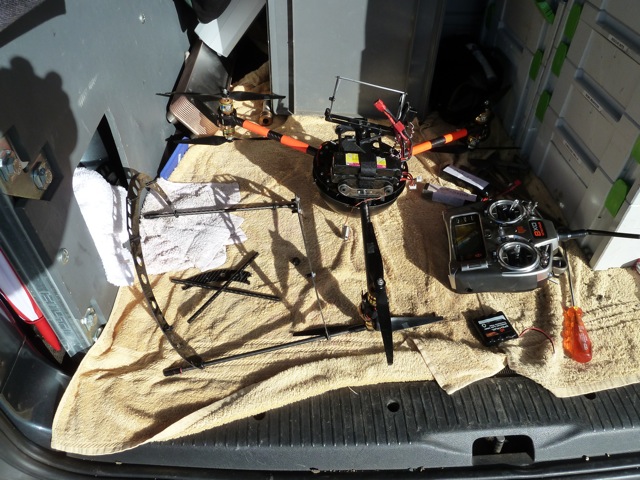

Not sure I would be going down the Spektrum route. I had a serious crash today busting my new HiSite II mount and snapping a landing leg. The DX8 crashed!! cant explain it in any other way.. ADX was to low for the TX loss to kick in to bring her down.. (I need to look at this more). When I tried to disarm the motors I saw my DX8 screen was blank.. then after a couple of desperate left stick movements to try and disable the motors it came back to life.. I cant tell you how my perfectly planned day was trashed.. GGGGGGGrrrrrrrrrr. :mad::mad::confused::mad:

No shortage of power on that one................. I would check out your DX8 power, leads and connections. The fact that it was dead and came to life with some stick stirring suggests it may be a loose connection. If all appears OK with the battery, leads and connections then I would get it back to the supplier for a ?????

A couple things about the DX8 and spektrum. There is a product bulletin out for the DX8 look on the Horizon page. Mine had the certain Pid # that could cause problems with the vibration feature. I sent mine in and they paid for shipping and the repair. Doesn't sound like this is what happened with you guys but it's worth taking a look. Also where you guys in Position Hold and using FPV? I lost signal with my Hexa before with my DX7. It started beeping and going into controlled decent. Thankfully I was high enough where my radio reset and I regained control before it hit the ground. Apparently a Low frequency filter is needed for both to work properly all the time. I plan on buying one as I'm going to have to do a lot more FPV for upcoming projects. Sorry to hear about your issues, I've flown my DX8 on a couple different things all with out issue. The Hexa, my foamie, and my blade MSR and never had any issues....knock on wood.
I am sure its something to do with the battery pack. Since the crash I have noticed that the displayed voltage will drop b y quite a lot very quickly then come back up? I am going to get it sent back but I doubt they will admit there is a problem with them. Its now annoying that you cannot just use rechargables and you are stuck to the Spektrums own packs, we only have the Nicad in the uk as all the Lipos seem to be gobbled up by the states!!

Pretty sure my issues were as a result of 'brown outs' in fact there is video evidence from another Spektrum user simulating a 'brown out' which occured at 3.9 volts ? This is a bit disconcerting, I am going to fit one of these to see if it helps matters.

No FPV or PH for me, just decending slowly after initial trim and it was a fresh Lipo.

I think this might interest you guys, this is from MK.de forum:
While explaining the issue with Horizon/Spektrum in Germany the Service Manager i spoke to suggested that using the DX8 satellite with the MK, either with or with out the diversity board, wasn't something he would particularly recommend.
As i understand it, this satellite module may (infrequently) need to communicate with the main receiver module - which obviously isn't present in the MK application.
We spoke to them in Nürnberg last month and they said the same. They don't recommend the sattellite of the DX8 in our application

Great! Just GREAT! That is the exact set up I use! Is it just the AR8000 receiver satellite that can cause issues or is it the whole DX8 set up? I've not noticed anything weird with the set up I have but this makes me very nervous. Did they say if it had to do with the AR8000 being DSMX?
Ellipz
It is AR8000 yes, older types don't have this problem. You would have to bind also with an older main-transmitter because they are not compatible.
