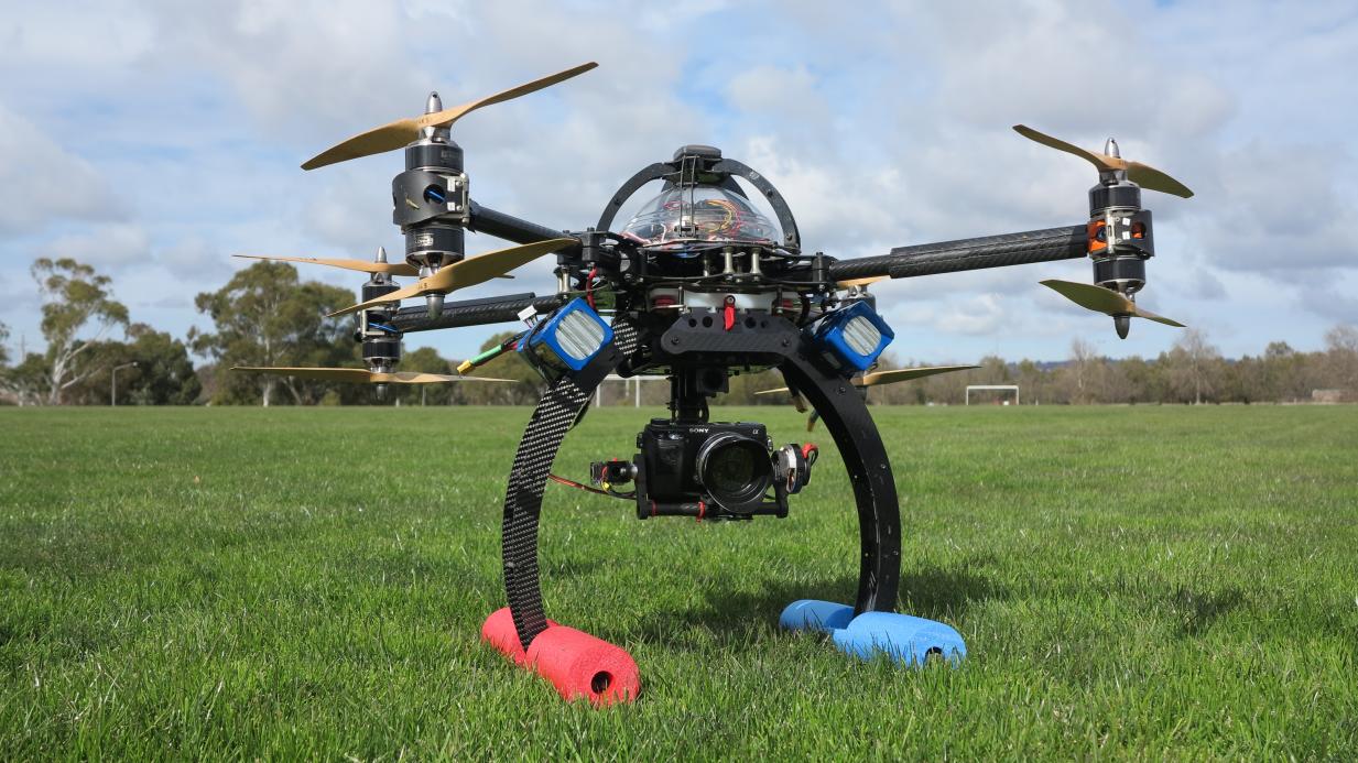

Last week I finally got my Droidworx SkyJib in the air and very stable. It was a real joy to watch it just sit wherever I put it and fly around with ease and precision. The hover throttle rate was way too high at 80% so some recalculation was required.
The outcome was to move up to either 6S batteries or from 14" to 15" props. I also thought it would be a good time to move from the APM 2.5 to an APM 2.6 with external compass. I already had a couple of 6S batteries but I decided to order 15" props as well to keep my options open.
Today I took it out with the 6S batteries, new APM 2.6 and my Sony camera on a brushless gimbal. I flew it without the camera first and it was a bit jumpy so I did a bit of in air tuning on it. I never did get it as rock solid as it flew the week before with the 5S batteries but it flew ok. So I went ahead and mounted the Sony and gimbal on to the Droidworx anti-vibration bracket for some tests. There was far too much vibration so it's back to the bench for more tuning.

Well, I finally turned the corner on all this and have things working quite well. Three things caused most of my issues:
1. There was no way this bird was going to fly the intended payload with 14" props and 5S batteries. I'm really surprised that the staff at Droidworx were ok with this selection. Although they did point out that there are a lot of variables and every build was different so they only make recommendations. But I would think that after selling thousands of copters they would pretty much be better informed than most people. Nonetheless e-Calc confirmed my choice wasn't that good and later on someone from Droidworx did recommend that I move up to larger props and 6S batteries. Easy to say but about another $1,000 out of my pocket. I also had to change the ESCs as there was conflicting info regarding if they could handle 6S voltage that I only discovered after one of them melted and shorted out in flight. The copter wasn't damaged but of course changing ESCs means virtually rebuilding the copter.
2. One of my big goals was to see if I could get an APM 2.5 flight controller to work with this copter. I'm quite involved in open source projects and know one of the Ardupilot programmers who I work with in a group that develops UAVs for search and rescue. I also want to be able to talk to those who develop the software so I know whats's going on. I had quite a few issues with the APM that I falsely put down to tuning issues. So that wasted a lot of time. The main issue was that in my comparison of how Bluerex's DJI based Droidworx copter flew I failed to realise that many people flying DJI flight controllers are flying in GPS modes whereas I was using the APM totally in manual modes given that the GPS modes in that FC are used primarily for autonomous flight which I didn't need for filming purposes. Indeed, at that point in time the APM software didn't even support take off and landing using GPS modes.
After long discussions with Ardupilot developers about using copters for video work the light globe came on and I started talking to them about how DJI works and why. They knew all that of course but I just don't think these things were the priority at the time. Anyway, it's a brilliant team of professional coders and they were already working on some things that turned out to be a game changer for me. The first thing that changed was that they added the functionality to take off and land in GPS modes. So this gave me a valid point to work from in comparing DJI and APM software from. I don't really advocate taking off in GPS modes but that seems to be what most DJI users are doing. Anyway, after adding this functionality to the APM I found that my SkyJib would perform damn close to what I was seeing with BlueRex's copter. Indeed, even with default settings and no PID tuning at all, the copter was flying beautifully even with my full frame Nikon loaded up. Needless to say I'm very happy about this.
3. The weather has been awful and slowed me down. For three weeks we have had high winds and I've only had a few one hour patches here and there to do any testing. So most of the time I just can't test as I tune the copter, add video TX and bring it all together.
