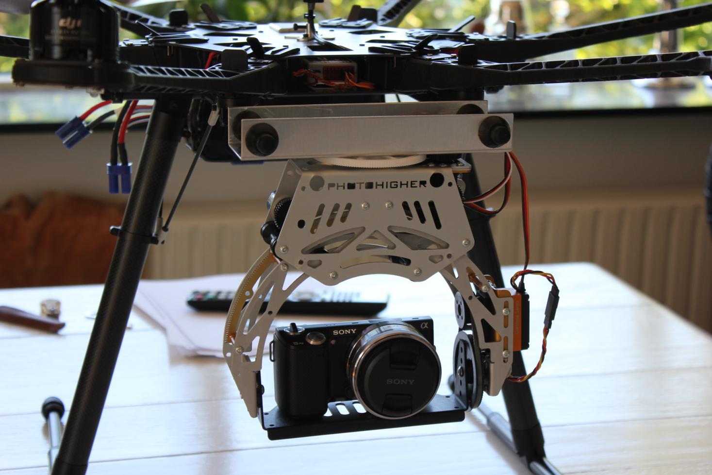

Boris, I am flying with 2x6S 5000mAh lipos with no gimbal. My flying weight it 4.65k. My guess is that with a gimbal and camera you are close to 7.5-8k. I don't have either so I am just guesstimating.
Well you have the zenmuse with
Weight880g (Without UBEC, HDMI-AV module)
Than A nex5 for example with a pancake lens:
Weight (Approx.) : Approx. 8.1 oz (229g) (excl battery & media) Approx. 10.1 oz (287g) (w/battery & media)
Zippy 6s 8000 may Weight: 1220g (including wire, plug & case)
So with out the lens and with out additional 2000 mah weight etc. You are around 2387g. So 2.5kg probably possible.

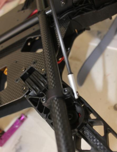

I was a little surprised to find that the S800 U/C stays don't fit correctly. For them to sit without causing a few stress raisers they need to attach at compound angles however they are drilled at 90 deg. I checked with dji and they are saying that a mod is coming. Ball joints would also do the job but in the meantime I would not recommend tightening those screws too much. View attachment 4468
