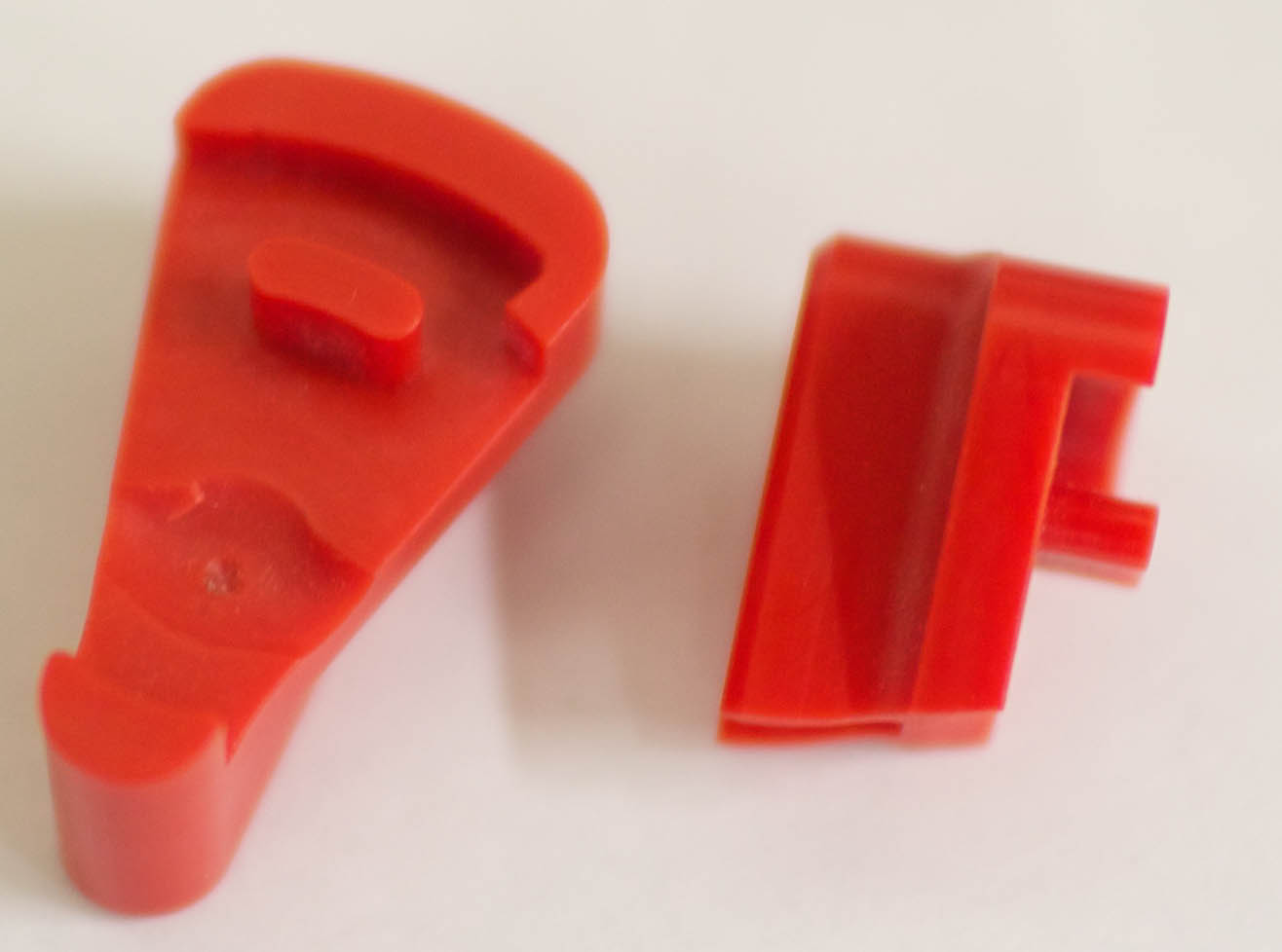

Here is a warning. We recently purchased a DJI S-1000 with folding booms as a feature. The RED PLASTIC BOOM LOCKS are FAULTY. The snap. These parts are made from cheap styrene plastic. Not only to they snap in the air but they can snap on landing. We now have a 15K boat anchor. We have sent emails to DJI with no response. Being here in Los Angeles we took the next course of action. We wen to the service center in which we were greeted with angst and shock and 100% wait 200% lack of service. The rep looked like he ust rolled out of bed and could not be bothered and told me they don't stock ANY PARTS and that I needed to send the entire S-1000 back to CHINA. Really? He asked who sent you , who gave you an RMA. We have a 2500 job this week that needs to be canceled because DJI sells faulty " Professional Gear" We have 40 yrs in RC and have never had such a poor experience. The rep was not even remotely willing to help. My next plan after this is to show up at NAB with rig in hand for everybody to see. Dealers , production companies , distributors and the list can go on. PLEASE see attached photos. BE ADVISED if these boom locks snap in flight you will end up with a catastrophic disaster and if you injure somebody lawsuits , loss of wages. DO NOT buy this product until there are parts readily available. Yes there are 4 spares in the box because I am sure DJI is aware of the problem. They are all broken. View attachment 17387View attachment 17388

yes it is a very very bad situation. The WILL break, yes they will. Prob with alum is that would will not be able to snap them over the tab on the knuckle. They need to be high impact abs glass reenforced. Z, in those weather conditions they will freeze and snap at any time. The plastic fatigues. I may be going to NAB with the rig an plopping the boat anchor on the table. No as you know the rig flys really well other wise. All of the spare have broken as well.

SO cal….the clips pivot into place and snap lock over the alum knuckle on the end of the boom. problem is the material will fatigue quickly but you never know when. They break in the same location. yes I have flown with out issue until the clips break. We have not had any crashes but now we have a boat anchor.

I believe one of the distinguishing features of the so-called 'Premium' edition s1000 kits is that the arm locks are anodized aluminum. So using this material is not just a theoretical possibility. Presumably the first units used CNC aluminum parts before, the injection molded parts became readily available. It will be interesting to see how widespread this problem is and whether/how DJI responds. And perhaps who will offer 3-D printed locks that are even more suspect than DJI's plastic ones may be...

DJI IS NOT RESPONDING at all. if you could see the DI office in Los Angeles you would be shocked at its state of disarray and the lack for experienced service. They send product back to China and there is NO support in North America. No 3d printed blocks is not the solution as they would not be cost effective or strong enough. They can not be made from Alum as you would not be able to slide the lock over the tabs on the end of the boom. They need to be made of high impact re-enforced ABS. The Premium only has a few machined parts. Not the boom locks.

They do snap into place its the vertical play that fatigues them
Think about the mechanics of how the forces from the motors and arms interact with the attachment point of the arm and I think you will find that this may not be correct.
it looks to me like those red parts only hold the arms in place until you start the motors and then the arms being held up by lift leaving the red pieces with no load on them at all. if the arm isn't going to the fully up position as the red pieces are being forced into position then maybe they'd break but forcing anything into position isn't good practice so if they break it's not really a design flaw.
what am i missing?
