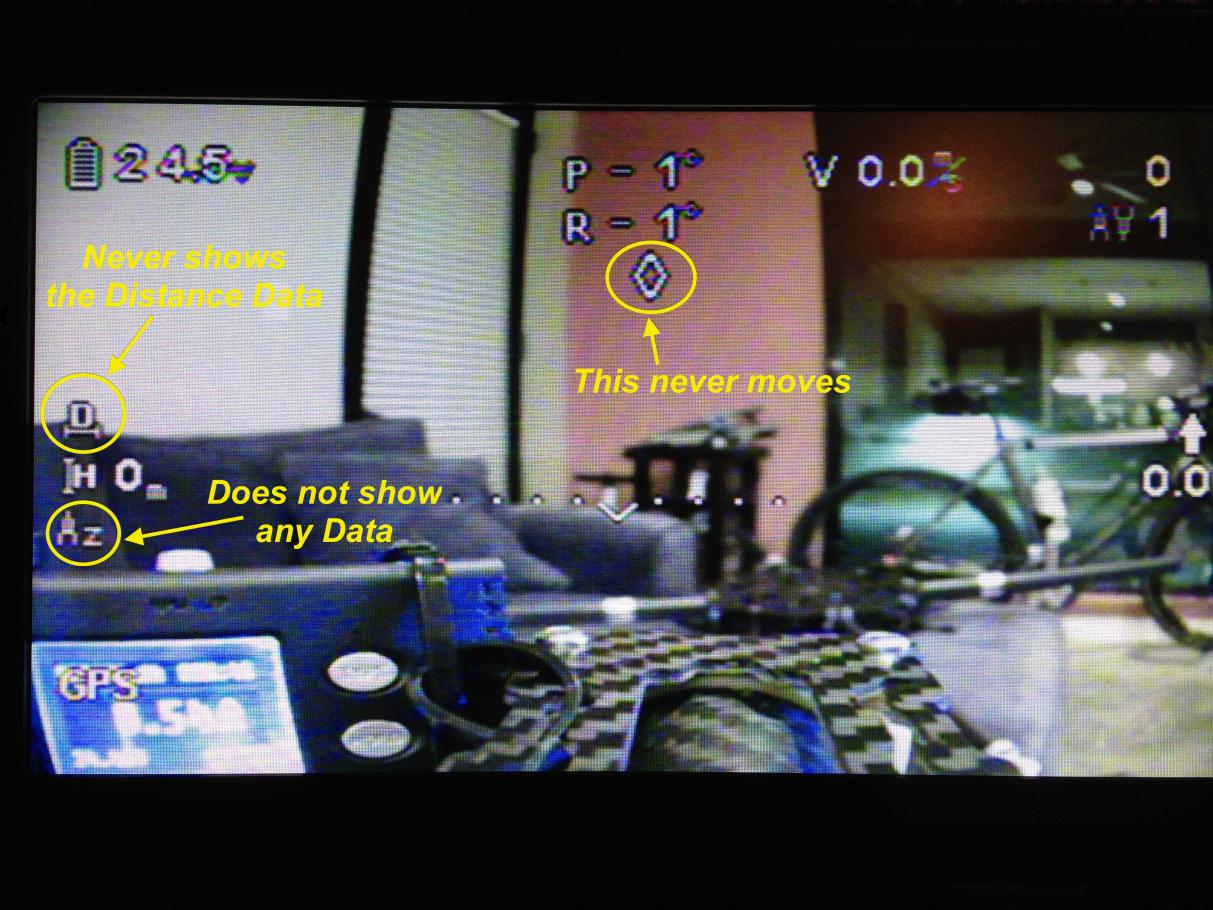

Hello everyone!
I have the DJI A2 FC and iOSD Mark II and with a successful recording of the home point, I have never been able to get the distance from home point to show the actual distance data. It just shows the "D" icon. Also, the direction to Home Point Marker also doesn't work, the marker icon just stays in the middle of the screen the entire flight. So, I upgraded to the new firmwares on all the DJI FC and components and Mark II and still no distance from home point, again it still only displays the icon. Also the new Az (Azimuth Angle) feature doesn't show any data just like the Distance doesn't. I tried DJI Support, but no dice. Anyone else having the same problems?

taylorddavis yes I am having the same problem.
Can both of you send some photos of what you are seeing? Thank you.

Hi Taylor,
Did you actually take off and fly, after you updated the iOSD's FW, or just test it on the ground...? I had a similar issue with mine on a WK-M, but it came good after a FW update, followed by a take-off...

Good point. I never think that many of the posts are bench testing. After flying things change.
This is a pic of what doesn't work while inflight with the home point successfully recorded. The pic attached was taken in my house on the ground as it is too late and cold to go fly :)View attachment 15434

Yes I flew it today to test after updating all the new firmwares with a recorded home point and 10+ satellites.
